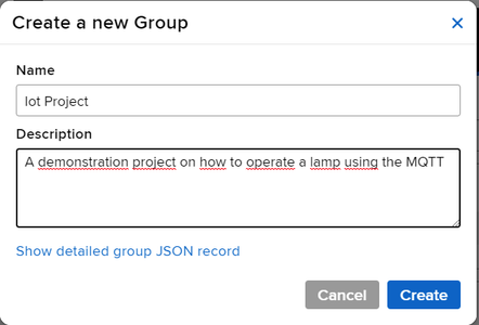

  1. After creating the account, you must create a group and a feed.
    • Go to Feeds> View all> New Group.

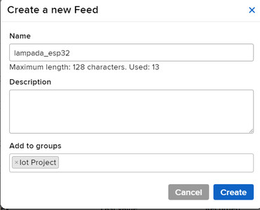

  2. After creating the group, click on New Feed in the created group and create a feed.

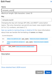

  3. After creatad the feed, open the feed and click on Feed Info to get the full address of the MQTT topic (MQTT by Key) that will be used in the source code below.

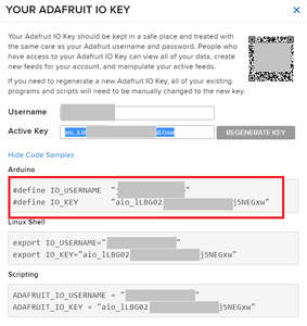

  4. In the main menu, select My Key. In the open dialog, you will see the IO_KEY that you will need to insert in the source code later on (Arduino).

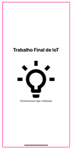

Step 9: Mobile APP
In this last step, I leave as a bonus a mobile application developed by a colleague to communicate with the MQTT server that I implemented in Adafruit (github link here).
The code is open, and will need to be edited to insert Adafruit's MQTT data (topic, key), in order to work correctly.
If you don't want to use the application, Adafruit provides a nice feature called Dashboard. In this functionality it is possible to create a panel and subscribe and publish on several topics.
