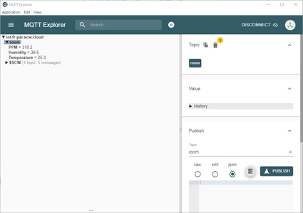

Meanwhile, it is also needed to have a comprehensive MQTT client that provides a structured overview of the MQTT topics and makes sure devices and services are working.
A lightweight MQTT client, "MQTT Explorer" can be found here.
Now the MQTT connection can be configured with the Host ("iot.fr-par.scw.cloud" or other, depending on the region chosen on Scaleway) and the Username ("YourDeviceID").
From here we will be able to check our topics and see if our data was correctly published to the client.

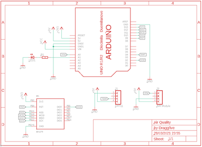

All the modules used can be implemented using breadboards and jump wires. The Sensor Module uses the Arduino UNO, and the Gateway the NodeMCU. Both modules can be powered through USB, or using a 7V to 12V supply to the DC Jack.

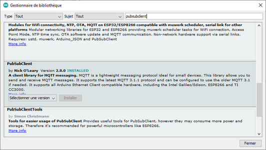

Then, the NodeMCU support has to be added. It can be done by going to File > Preferences... > Additional Boards Manager URLs, and to add http: //arduino.esp8266.com/stable/package_esp8266com_index.json to the field. After that, going to Tools > Board > Board Manager... will allow to add esp8266 support.
Finally, the LoRa and PubSubClient libraries can be added with Sketch > Library > Manage Libraries... PubSubCLient is used to perform MQTT requests.
The sensors functions are provided with the Git repository, and based on the work of Mark Ruys for the DHT11 and Georg Krocker for the MQ-135.

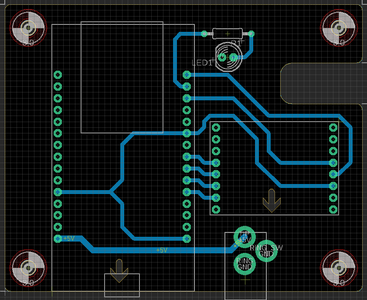

If you have the necessary material, you can use the files provided in the Git repository to create some PCB and casing. If you have SOLIDWORKS, you can even modify the files to make custom casing. The PCBs were on their sides created with Autodesk Eagle.
Just uses the Gerber files to make the PCBs and the 3MF files to print the casing, and you will have some robust modules !

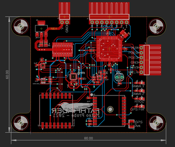

Lets quickly present this work in progress, making a full standalone beacon, able to communicate its pose, geoposition, the ambient light, temperature, humidity and pressure.
Respecting the IoT principle, the module would consume few power. As Arduino and all made module are not really suitable for that, a microship PIC32 is used here. It has, among others, the ability to enter in deep sleep mode, and to manage a date to wake up.
The sensors used are the following:
- GPS Module from Adafruit
- BMP388 pressure sensor from Bosh Sensotec
- Temperature and Humidity sensor from Wurth Elektronik
- IIS2MDCTR magnetometer from ST
- ICM-20649 IMU from TDK IvenSense
All of these sensor's power sources are managed from the PIC in order to disable them during sleep.
The power source used for this module is a 3.7V Lithium Polymer battery, charged thanks to a solar panel module. The beacon is then fully autonomous, and can last forever when it is well configured.
As it uses the same LoRa module than before, the beacon can communicate with our Gateway !
This module embed very little parts. It then cannot be made with amateur tools. What is planned here is to manufacture the board, giving it to a company like PCBWay. If a "raw" PCB is quite easy to order provided you know how to generate Gerber Files, ordering an assembly requires to provide a Bill of Material (BOM), listing all the components references. A Pick and Place (PnP) file is also needed, which tells where the components are placed on the board. PCBWay then allows you to decide who provides the parts. it is important to notice that assembly service is more expensive than PCB manufacturing. Here, for example, 5 PCBs can be ordered for 5$. One Board to assemble costs 174$ (86$ for components, 88$ for assembly). But the result is much more professionnal !
