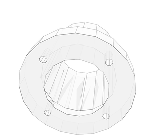

Step 6: Create the Mounting Bracket
Initially, I wanted to mount the Hall effect sensor on top of the sensor so that I may be able to calculate the distance from the indicator, but I found the magnet/sensor combo I had didn't have the range to support this. So I created a second bracket and mounted it at the bottom so that I could detect when the magnet got to the 1/4 tank mark. I have attached the .stl files for this bracket for 3D printing.
Once you have the sensor module and NodeMCU installed, you can test and ensure that the readings are consistent with the previous configuration.
