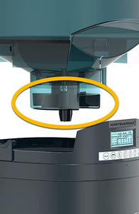

As shown in the first picture, almost all the cat feeders are in the form of bin + plate. Now we know what should our cat feeder look like.
We can also click to view the promotional pictures or videos to figure it out.
As can be seen from the above figures, the machine makes use of the gravity of the cat food. There is a rotating structure at the bottom of the bin to stir and push the cat food out.
Now we have a basic idea of the machine's structure.

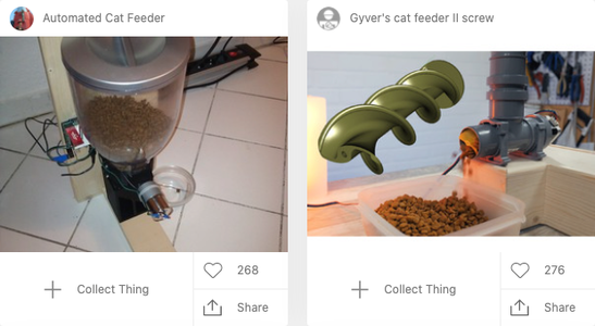

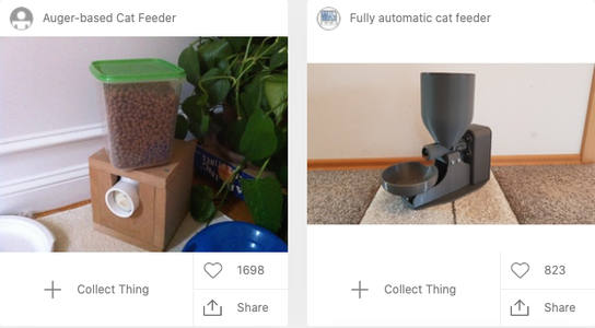

Step 3: Collect Information - Thingiverse
The second station of information collecting: https://www.thingiverse.com/
Thingiverse is a global 3D model sharing website, which shares a variety of interesting and fun models. You can first go and see if there is a cat feeder model, then we don't need to model but just print it directly (Sometimes we can be "lazy" ;)
Many people have shared their models on the website, you do can print them directly, but the 3D printer we made before may not be big enough for them. Also, the models they share all include their special items, such as bottles with a strange shape, which we definitely do not have. So we decided to make a 3D model by ourselves.
From the website, it seems that the easiest structure of the cat feeder is of the screw form, so we will model according to this form.

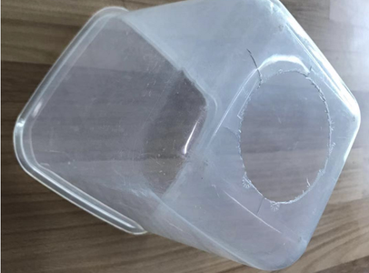

Step 8: Dig a Hole on the Storage Box
Use a utility knife to dig a round hole at the bottom of the storage box (55.6mm in diameter)

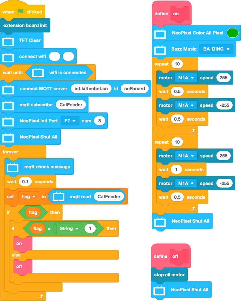

Step 13: Write the Program
Write a graphical program with Kittenblock according to the flowchart.
You need to modify two things:
  • Change your WIFI name and password
  • Change the topic name (replace my CatFeeder)
Program Download:📎Cat Feeder Program.zip
