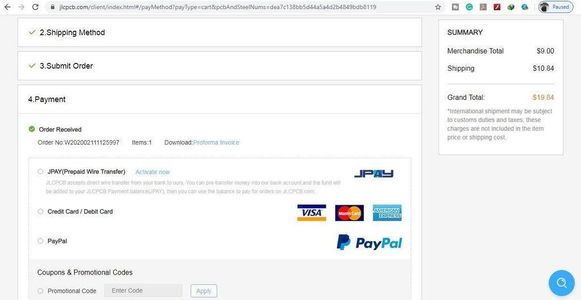

Step 6: Select Shipping Address and Payment Mode
  1. Type the Shipping Address.
  2. Select the Shipping Method suitable for you.
  3. Submit the order and proceed with the payment.
You can also track your order from the JLCPCB. My PCBs took 3 days to manufacture and arrived within a week using the DHL delivery option.

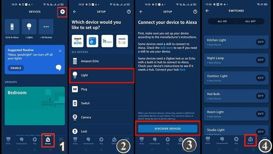

Step 11: Configure the Alexa App for the Smart Home System
While configuring the Amazon Alexa App, the ESP32, Amazon Echo Dot and the smartphone should be connected to same the WiFi network.
Open the Amazon Alexa App and follow the steps:
1. Tap on Devices. Then Tap on the "+" icon.
2. Tap on "Light", then select "Others".
3. Select WiFi.
4 . Tap on "DISCOVER DEVICES". (It will take a minute to add devices.)
5. Tap on "Devices", and tap on "Lights" to see all the devices.
Once the Alexa App finds all the devices, you can control those devices with voice commands using the Alexa Echo Dot.
