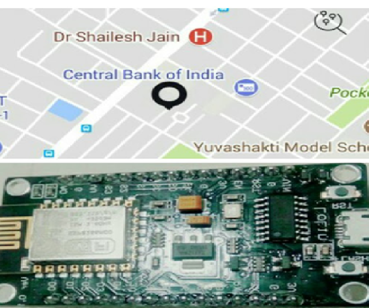

12. After it set the parameters in tools according to the following image
For Better understamding see the above image
