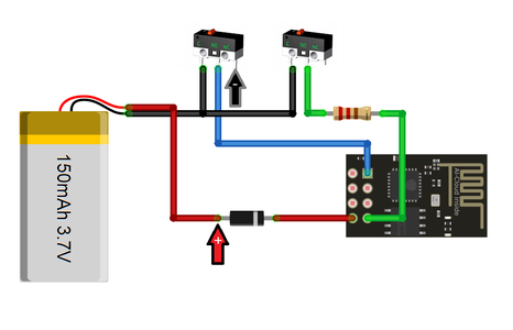

Electronic parts needed:
  • ESP-01(S) and another ESP as a receiver (you can use your existing IoT device, for example connected to the MQTT broker)
  • 150mAh LiPo battery (~ 24mm x 16.6mm x 7mm) or smaller
  • any diode with a voltage drop of 0.7 V
  • 1kΩ resistor (or similar; at least 330Ω)
  • 2x micro switch (~ 13mm x 6mm x 7mm, like DM1-00P)

Step 4: Solder and Assemble Everything
Solder everything as shown in the diagram and pictures. I left the positive leg of the diode sticking out, because it will make it easier to charge the battery.
Step 5: The End
Charging
The arrows in the diagram from the previous step are points where you should connect LiPo charger (e.g. TP4056) with jumper wires. But don't worry, you won't have to do it too often :)
