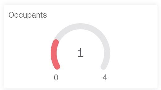

Let's leave the climate aspect for later and discuss now the Presence Detection. Our Smart Home System can register users, and detect when these specific users are home. There are many different approaches to this problem, none of them perfect; we encourage you to find your own solution, but here are two possible solutions to consider. Let's look at both.
Geofencing - This is marking a certain area, and keeping track of the users location, using a phone for example. When the user's phone location falls within this area, you can send an alert to services such as Make (formerly Integromat).
IP Pinging - Pinging is the concept of sending a message to a device, and marking how long it takes to receive a response from that device. A device, when connected to a Wi-Fi network, is assigned a random IP address. This method involves reserving a specific local IP address (specific to the home router) per registered user, and pinging this address; if you receive a response, it means this specific person is home and connected to the Wifi.
Both methods contain drawbacks.
Geofencing Drawbacks - The drawback of Geofencing is that it requires invasive phone permissions and can be inaccurate. Permissions require you to either develop your own app (complicated with iPhone due to Apple restrictions) or use an existing app (which costs money and might not work as well as you want, and integration can get complicated if you have multiple phone types in the house, e.g iPhone and also android). Also, getting each user to download the necessary app can be a hassle.
This was our initial approach, however it was quite complicated to implement. In addition, our location currently suffers from GPS jamming due to certain world events, leading to this method being highly inaccurate for us (it said we were 200 kilometers away from our actual position).
IP Pinging Drawbacks - This is the method we ended up using, and worked surprisingly well. The main drawback of IP pinging is that every once in a while a ping might fail, and a device might be connected to the cellular network rather than your local wifi network (should be possible to find a workaround with this via things like port forwarding perhaps, but we found local IP address to be good enough). The key part of this is that the IP address must be static, so that you know which device corresponds to which person (otherwise if people owns multiple devices for example, you can't really tell how many people are present).
One benefit of IP pinging, is that it's very easy to add new users; all you need to do is to log into your router's homepage, and set the desired device's IP as static, and write it down. This takes minimal effort on your part, and no effort on your guest's part.
Considerations -
1) Both of these methods are frankly better at answering the question of "Who" is home, rather than "How many people" are home. This is because these devices rely on manually registering users, so if a guest not from the household (who hasn't been registered yet) enters, they won't recognize them.
Alternative methods such as cameras and computer vision might be better at this, but they come with their own drawbacks and considerations; we ended up considering the above two methods as they were simple enough and worked well enough; any frequent guest could simply be added to the list of known people quite easily, and non-frequent guests would most likely be accompanied by a house member.
2) A hybrid approach, which combines these two, may also work well and compensate for some of the drawbacks of both. We didn't end up doing this, because the current GPS jamming made geofencing irrelevant.
We also note that our pinging specifically targets phones, rather than PCs. this is for two reasons:
A) practical - 99% of the time, people bring their phones with them everywhere. That's not necessarily true for PCs and laptops, which might be left at home while the person themselves are away.
B) necessary - computers often have stronger firewall protocols and don't respond to random pings from unknown devices. Rude!! (of course there are workarounds for this, but that brings us to the invasive drawback of geofencing).
Our Implementation
Regarding the two drawbacks of IP pinging (ping failure and not connected to the Wifi network), we figured that the second isn't too important as it is a fair assumption that most people in our household auto-connect to the network within range.
Regarding the first assumption (ping failing to receive response sometimes), rather than defining a person as absent if pinging them has no response, we defined a person as absent if three attempts in a row had no response. As we ping every couple of minutes so as to not overload the Arduino and to perform other processes (we will expand on this at a later stage), this means that detection of a person leaving the home is not instantaneous, but it has less noise and is more precise.
Therefore, our Presence Detection algorithm works as follows:
  1. Go through the list of registered users, and ping each one of them.
  2. In between each ping, wait a short while to not overload Arduino and to do other arduino processes if necessary
  3. If a user is unreachable when pinged, increment an 'absent counter' for this user by 1.
  4. if upon incrementing, the counter reaches 3, it means they were unreachable in the last two iterations as well, and change their status to away from home.
  5. If they are pinged, mark them as present at home
  6. After all users have been pinged in the current iteration, count how many people are at home, and who.
This means that our current list of present people will be outdated by at most 3 cycles/iterations of the algorithm, but will be much more precise and have less noise.
A very important note is that we don't iterate through all of the users in one go. This is because we don't want this function to block the rest of our Arduino functions, most important of which is the Blynk.run() command, which keeps the Arduino and Blynk connected (we explain this in a later section). Instead, assume someone else instructs the Presence Detection when to ping the next user in line.

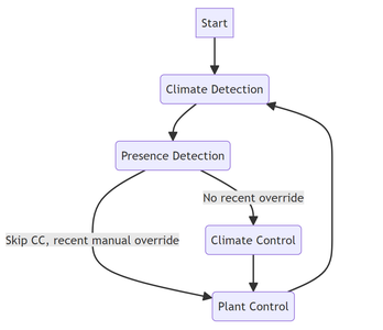

Step 5: Climate Control
Designing the Iteration Logic
The "Climate Control" section is really just a long series of ifs and if else's, and uses all of the previous steps. Using input from the detect presence and temperature detection, lets first get a pen and paper and plan out our Climate Logic.
We want our A/C to act differently according to different situations. For example,
"If the AC is off and it's hot, turn on the AC on cold mode"
"If the AC is off and it's cold, turn on the AC on heat mode"
"If the AC is on and it's neither hot nor cold, turn off the AC"
"If the AC is on and on heat mode, but it's very hot, switch to cold mode"
"If nobody is home, turn off the AC and disable the Automatic Climate Control until someone is home"
These are just a few example use cases, all of which we used in our project. We can map this all out on a decision tree, for example, and in terms of code it's just a matter of following these if-else statements. Leaf nodes in the tree call upon the corresponding AC instructions as detailed in the "Transmitting the A/C commands" step.
In terms of code readability and modularity, if you really care about design and are using an OOP language, this is a great time to create an "Air Conditioner" class with properties such as the current AC settings. The Climate Handler would then check each time the air conditioner's properties (Is this AC on/off? Is it on Cold mode? etc...) and act accordingly. Example
This approach is great because if you wish your smart home system has multiple A/Cs in the home, it's merely a matter of iterating the climate handler on each A/C. In our project we had only a single A/C, but extending this to more should be a trivial task with proper implementation

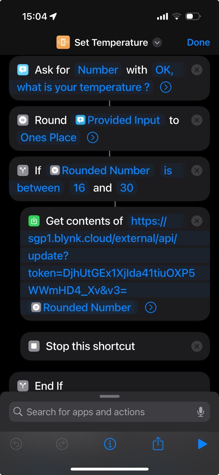

Lastly, head to the Testing section of the "Developer Tools", and grab the API HTTP links for each pin; see the attached photo for an example:
https://sgp1.blynk.cloud/external/api/update?token=VXqBqE4YKtpBV7vejvomczEIRFaFUR7p&v0=1
is an example URL. This URL contains two variables - our API token "VXqBqE4YKtpBV7vejvomczEIRFaFUR7p" (which you should keep secret! This is just an example token) and the new value of the v0 virtual pin, 1 "v0=1". Whenever someone visits this URL, the v0 pin will be set to this value. If you replace the 1 with 0 ("v0=0), then whenever someone visits this URL, the v0 pin will be set to 0.

Integrating with iPhone Voice Commands
iPhone has a handy "Automations" app; using this, we can have Siri visit the desired URL upon certain voice commands.
Now that we have our REST API links (the http links you made previously), Siri will then visit these URLs depending on which voice input you give her, which will then modify our Blynk virtual pins. These pin value changes will alert the Arduino, which will then transmit new instructions to our AC using the infrared light.
For example, I suppose I had a virtual pin for the AC temperature. In this case, I could provide the voice command "Set Temperature", and then have Siri prompt the user for a number, and it would visit the corresponding URL. For example, if our temperature pin was V3 and we wished to set it to 16 degrees, this site would be visited:
https://sgp1.blynk.cloud/external/api/update?token=VXqBqE4YKtpBV7vejvomczEIRFaFUR7p&v3=16
(of course, your API token is different).
We've attached an image of the Set Temperature automation we used; the other commands are just as straightforward.

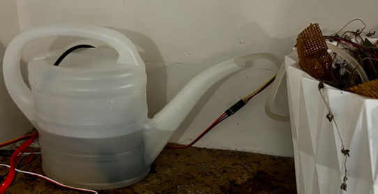

Step 7: Plant Control
The soil is dry. Therefore, turn on the pump for X seconds. Then, turn off the pump. The soil is no longer dry. Ta-dah!
That's the main concept of the plant watering system; it obtains the soil moisture values from the sensor we calibrated in the Climate Detection step; then, if necessary, it activates the pump for a short while before turning it off. Logically, it's not complicated.
The main questions you should ask are:
How do you turn on/off the pump?
In our case, and I assume in most cases (I don't know, I'm not an expert in small aquarium pumps), the pump works consistently as long as it's connected to an electric current. This would flood our plants, which is probably bad.
For this reason, we got a plug with a switch on it; when the switch is on, electric current is let through. When it's off, none is let through. Perfect!
Using a cutter, we cut off the head of the aquarium's plug, and wired the cable to a our new plug.
So, now our pump, when placed in water, indeed pumps or doesn't pump! We just need to turn on/off the switch. However, this brings us to another question:
How do you turn on/off the switch?
That's simple. Servos!!
Servos rotate; this rotation can press the switch. In our case, we added bits of glue to the switch to provide a better angle for the servo to apply force, however this probably isn't necessary.
There's just one catch: pushing a switch may require quite a bit of force. That's fine; the arduino automatically sends more electrical power to the servo, to overcome this resistance. However, this leads us to a new problem -
Depending on your switch, the arduino might send too much power to the servo and shut off / reboot.
To solve this problem, we attached to the arduino the power module.
Finally, using our fifth virtual pin, we can create a "Water Plant" button on the Blynk dashboard to enable you to override the automatic plant waterer and water your plant even more - great if you're away from home and expecting a hot day! This implementation is identical to what was explained in the Blynk section.

How do we integrate all of this? The answer - a finite state machine.
Why States?
This may isn't necessary, but it enables you to greatly simplify the code. Rather than having all of these different components act together all at once, and maybe interrupt with each other, it's best to give each component its own turn (e.g if time is important factor, for example amount of time watered, you don't want to start watering and then have another function take up a lot of time before you can turn off the water. Again, don't flood the plants!).
The reason this works is that it makes your system's logic simpler, easier to program, and more efficient, by providing each unit its dedicated time to work. We don't actually need to activate each of these units every single second really (for example, we can detect presence every few minutes, check the room temperature every few minutes, etc.), so this works well.
State Logic
So, lets' define four states: Climate Detection, Presence Detection, Climate Control, Plant Control. Clearly the latter two depend on the first two for information, such as soil moisture or how many people are in the house. So the first two states need to come before the latter two.
Let's also consider manual override; if the AC had a manual override, the Climate Control should skip its turn and go immediately to the next step.
Taking into account these two requirements, we can propose such a state machine as the attached image.
Implementation
One of Blynk's most powerful features is the BlynkTimer class, which activates certain functions each interval. We can have up to 16 different timers at once per timer object, but then things might get funky with constant interrupts and switches to each function.
With timers, we can avoid overloading the Arduino with constant functions (e.g temperature detection) and do so only as much as needed. When a module has finished its work after a series of timer calls, it passes its turn on to the next state in line.
With our state logic, we just need one single timer at any given time; a switch from state A to state B would look something like this (pseudocode):
reset timer(Ainterval,Afunc)
set timer(intervalB, Bfunc)
Although there are FSM libraries for Arduino such as Arduino-FSM, for our use case of a cyclical machine with 4 states, this was so simple we didn't see a point in using such a library; a simple switchState function was enough. Our code had a corresponding function for each state, as well as a switch function which switched to the state's function.
This state function was responsible for turning on its corresponding module's code, as well as deciding when to switch to the next state.
The Presence Detection system for example, switched a state after each ping.
The Plant Control state switched state only after it finished watering the plant.
The Climate Control switched states immediately if a manual override occurred recently (which we keep track of by storing a time variable using millis()), or after finishing its flow chart logic.
