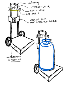

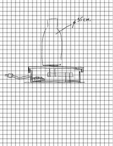

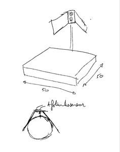

Step 6: The Housing
Wooden housing machined and glued together to become this housing
I first started sketching how I wanted the case to look, something important was that it had to be big enough for everything to fit in since we got a big circuit to put in the case but had to stay compact so that it didn't take alot of space.
It is important that you position the weighing sensor as best you can. I mounted it on two wooden boards with bolts and nuts. On top of that I mounted a wooden plate that serves as a weighing plate. All this in a wooden housing with enough space for the electronics.
How big the shelves are in your case doesn't really matter this depends mostly on how big the things are that you are going to weigh. As long as all the electronics fit in the box it is good.
I made the case out of wood, I think it is the easiest to work with when you don't have that much experience with building cases and you also have a lot of things you can do with it.
I started with making the case out of leftover carton I had laying around to avoid redoing the wooden case multiple times. Try doing the same so you still have room for error!
