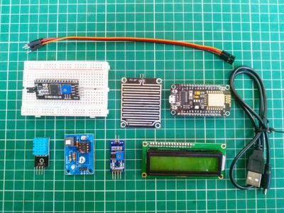

Step 1: Material Required
  • NodeMCU (EP8266 MOD)
  • DHT11
  • Rain Sensor
  • LDR Sensor
  • 16×2 LCD with I2C module
  • Breadboard
  • Jumper Wires
  • Blynk App with Wi-Fi connection

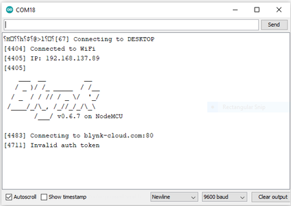

void setup() {
  Serial.begin(9600); // See the connection status in Serial Monitor
  lcd.begin();
  lcd.backlight();
  Blynk.begin(auth, ssid, pass);
  dht.begin();
  // Setup a function to be called every second
  timer.setInterval(10L, weather);
void loop() {
  Blynk.run(); // Initiates Blynk
  timer.run(); // Initiates SimpleTimer
