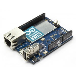

I chose the Arduino Yun for this workshop because it has both a Linux distribution and on-board Wi-Fi, although several of the labs can be completed using any Arduino board because the Node.js code will run on your laptop and use the Arduino over USB. If you want to deploy the applications you build to the Arduino, you will need a board that has a Linux distro (such as the Yun or the Linino ONE).

  1. Arduino Yun (1)

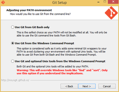

Some of the tools you will be using in this workshop require Git. The download link can be found here.
Windows Only
During the Git install, check the option to Use Git from the Windows command prompt (see image above).
If you don't choose this option, after you have installed Git, you need to add the path to get to your development environment. To do that, add the path to Git to the PATH environment variable.
Open Control Panel > System and Security > System then click on Advanced Settings.
Click on the Environment Variables button toward the bottom of the dialog.
Locate the User variable named PATH and double-click it.
Append the following to the Variable value textbox (if you installed Git to a different location you will need to modify this value accordingly):
;C:\Program Files (x86)\Git\bin;C:\Program Files (x86)\Git\cmd
