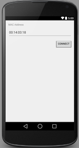

Step 3: Setup You Andriod Application
This android application needs some improvements to detect MAC address, you need to insert the MAC address manually, for simplicity I hard-coded the first 4 bytes they should be the same for all HC-06 from same supplier.
you can find the Android application source code using Android Studio here, and tweak it to fit your module
https://github.com/ahmadsayed/MQTTSerialTethering
Hint: Please insure your phone paired with the HC-06 and your bluetooth turned on before press connect

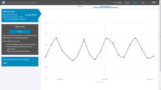

Step 4: Testing Your Application
This is just a sample to test your connectivity setup, we are going to use IBM provided quickstart service you can use it to it chart your sensor readings, just provide the HC-06 module MAC address and wait for the reading.
Upload attached test.ino to your Arduino, insure updating line 7 with your module info
for example if your mac address is (00:14:03:18:XX:XX), your constructor should be as follow
MqttSerial mqttSerial ("d:quickstart:instructable:00140318XXXX",bluetoothSerial);
the attached code read A0 Analog input pin and publish the data over quick start Mqtt protocol and the data get charted by this magical IBM web page

Step 5: What Is Going to Happen
Finally, it works the result is from my experiment, this is not an actual sensor data but it is the noise on A0 pin however it gives a very interesting chart too :) :)
