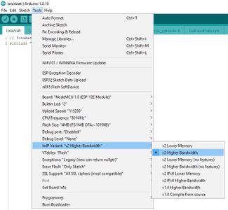

5) Plug in the IoTaWatt with a USB cable and open the Arduino IDE
6) Select the NodeMCU 1.0 (ESP-12E Module)
7) Set the lwIP Variant to “v2 Higher Bandwidth”
8) Set Erase Flash: “All Flash Settings”
9) Set Flash Size “4M (FS:1MB OTA~1019KB)”
10) Select the Port: the IoTaWatt is connected to and select Sketch → Upload to reprogram the IoTaWatt
