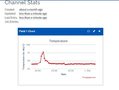

The code is quite simple. You need to change apn as per your service provider. Also, you need to change the api key for thingspeak channel.
