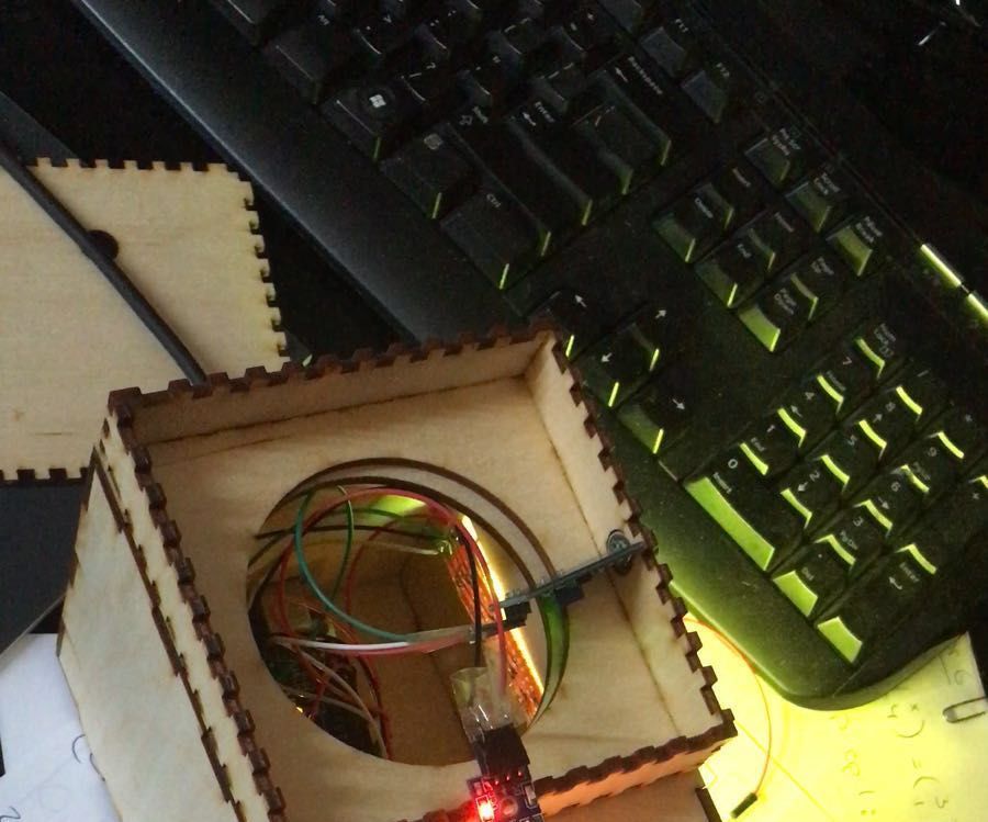

Step 2: Making the "Push Button"
First we need to make the thing in the pictures above.
I folded some paper and bended it. I taped it together to keep it in place. (3 cm long, 0,5 cm wide)
Then you will need some tin foil, cut the tin foil in the size of you're paper creation. Glue this on the convex side of it. then tape it aswell, but only in the middle.
Because it's paper it will never get straight again (by itself).
This will be used later as a "push button".
Step 3: Making the Connection
Now we are going to make the circuit.
Grab yourself 2 electricity cables and cut of the plastic.
you should have a cable with 1 side of just copper, this side must be aslong as your "push button" plus about 2 centimeters.
Now glue this to the smaller rectangle (in my picture of things needed). Use barely any glue, it's just to hold it in place. Don't glue the last 2 cm of the copper.
Bend the last 2 cm of it in a 90 degree angle. The end of it will be under your push button.
Now cut a piece of tin foil about 1x1 cm. tape this over the end of you copper cable.
Next up we're going to apply the push button.
Cut a second electricity cable, this time you'll only need about 2 cm of copper cable.
tape the end of the copper on the tin foil side of your push button.
Now glue and tape this right above the tin foil square you just made.
If you press the paper down it should touch the tin foil. Make sure there isn't any tape between it.
Now connect the positive side of you battery to the negative side of your led.
Connect the negative side of your battery to one of the cable on the back of the rectangle we have been using.
Connect the positive side of your led to the other cable. Don't forget, the cables need to go through the wood if you make it like mine. Solder this to make it secure when you're sure it works.
If you press the paper down the led should light up.
