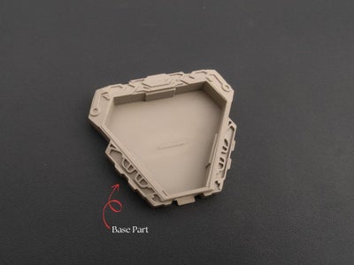

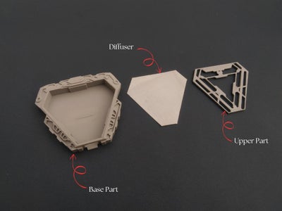

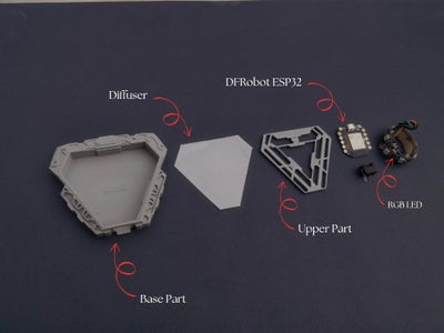

Step 1: Design & Print
To begin, I designed this iron man Arc reactor using Fusion 360. Since the design was two old so the link of fusion 360 is not available for modification. Although I'm providing the STL files for directly 3D Printing. The files are listed below:
- 1x Iron Man Based.stl
- 1x Iron Man Middle.stl
- 1x Iron Man Top.stl
Since I haven't a 3d Printer, so I'm using pcbway 3d printing service. PCBWay offers high-quality, precise, and affordable 3D printing for hobbyists, engineers, and designers. With advanced printing technologies like SLA, SLS, FDM, MJF, and DMLS, they ensure top-notch accuracy and detail. You can choose from a wide range of materials, including resin, plastics, and metals, at competitive prices. Their fast turnaround and global shipping make them a preferred choice for rapid prototyping.

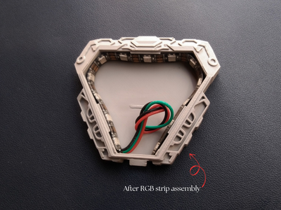

Step 2: RGB Strip Assembly

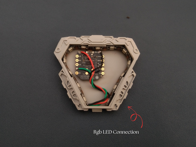

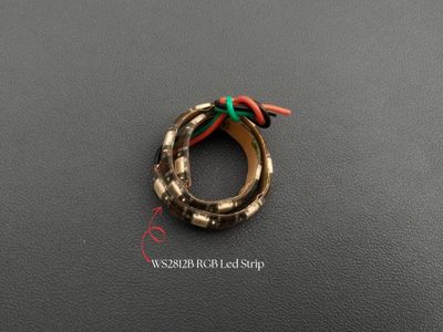

I began by carefully measuring and cutting the LED strip to fit snugly inside the reactor’s inner frame. The strip I used came with a pre-applied adhesive backing, so I simply peeled off the protective layer and pressed it firmly into place along the inner edge.
Once the strip was in place, I soldered the three key connections: 5V (power), GND (ground), and Data In. It's important to ensure the data flow direction is correct—the arrow on the strip should point away from the microcontroller input. A reversed connection could prevent the lights from responding.

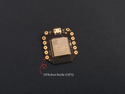

While a standard ESP32 would have done the job just fine, I chose the Beetle ESP32 for a specific reason: its ultra-compact size combined with high performance. In a project where space is limited and aesthetics matter, the Beetle ESP32 was the perfect fit. It packs the full capabilities of the regular ESP32—Wi-Fi, Bluetooth, and plenty of GPIO pins—into a tiny form factor, making it ideal for embedding into tight enclosures like this one. This microcontroller is responsible for controlling the WS2812B LED strip using the WLED firmware, which allows real-time lighting effects via a smartphone.

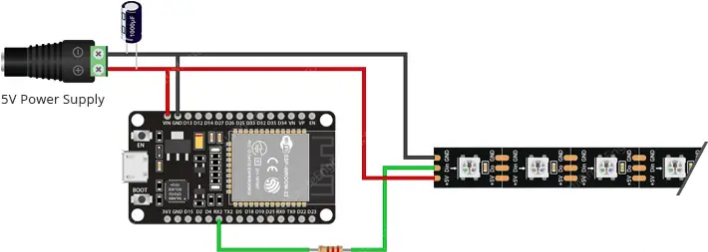

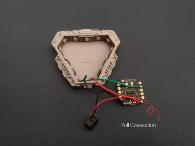

Step 4: Connection
You can follow the above circuit diagram to make the connection, however I choose GPIO 2 of DFRobot ESP32 for Connecting Din Pin of Ws2812b led Strip. In the above circuit diagram you can see some safety comments like resistor and capacitor, you can connect if you want otherwise the ESP32 can even handle smoothly.
Connection of WS2812B RGB led Strip With DFRobot ESP32
- WS2812B Strip VCC Pin To DFRobot ESP32 VCC Pin
- WS2812B Strip GND Pin To DFRobot ESP32 GND Pin
- WS2812B Strip DIN Pin To DFRobot ESP32 D2 Pin
Connection of 5V DC Jack with DFRobot ESP32
- 5v DC Jack Postive (+) Pin To DFRobot ESP32 VCC Pin
- 5v DC Jack Negative (-) Pin To DFRobot ESP32 GND Pin

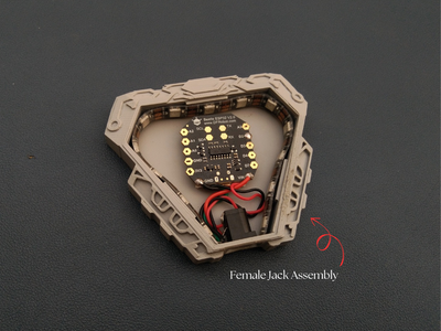

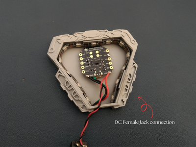

Step 6: DC Jack Assembly
I placed the DC jack into its designated slot in the back part of the reactor. It fit just right, and to keep it firmly in place, I used a small drop of super glue. This keeps the jack secure while still maintaining a clean and sleek look.
Once fixed, the jack connects directly to the 5V input of the LED strip and microcontroller, making it easy to power the reactor using any compatible adapter.

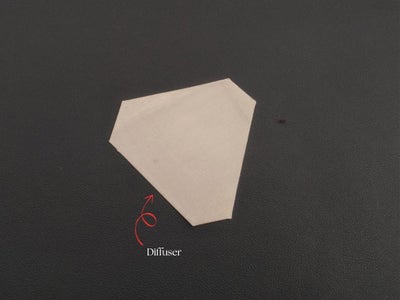

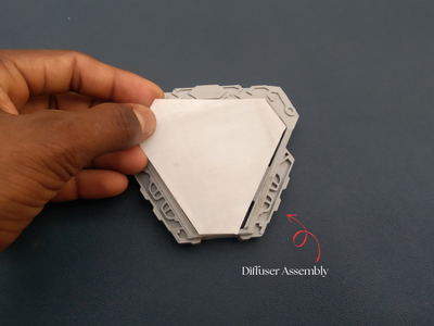

Step 7: Diffuser Assembly
Now when everything is done, it’s time to add the 3D-printed diffuser on top. This not only gives the Arc Reactor a clean and finished look, but also helps soften the light so it doesn’t appear too harsh or direct.
Once the diffuse place on its place, carefully apply a small amount of super glue, so that it can fit perfectly.

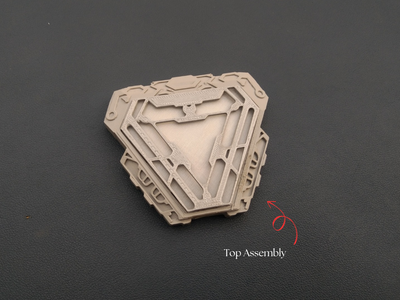

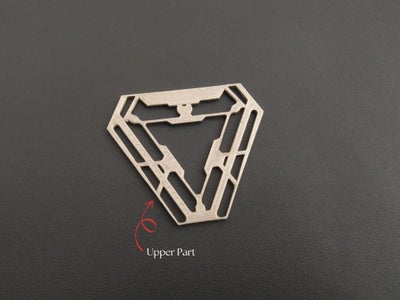

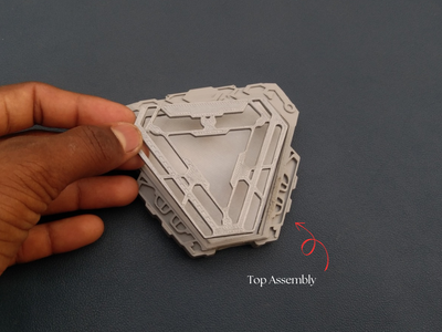

Step 8: Top Assembly
Now it’s time to complete the look by attaching the top 3D-printed panel of the Arc Reactor. I carefully aligned the top panel over the diffuser and pressed it into place. To make sure it stays secure, I added a small amount of super glue at the edges. Just a little is enough—too much can overflow and affect the finish.
