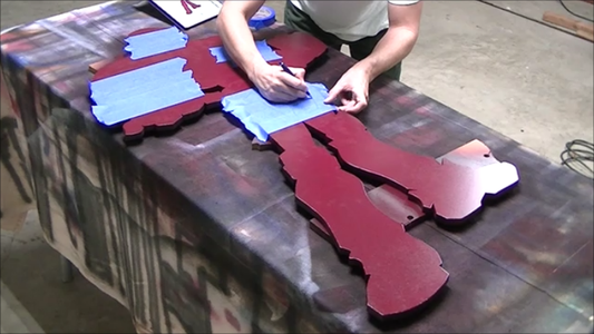

Next I masked off the areas that would be painted gold. Then I laid the template over the tape and traced the outline of the gold areas with a ball point pen applying a light constant pressure. Tracing the template leaves an impression on the tape that you can use to go back over with the ball point pen. Also it helps to have a photo for reference to make sure you are tracing where you need to trace.
Step 11:
Once you the gold areas are marked I then cut out the shape with a razor. You don't have to press to hard on the razor as the tape is cut fairly easily. Then I peeled away the tape to expose the areas that would receive paint.

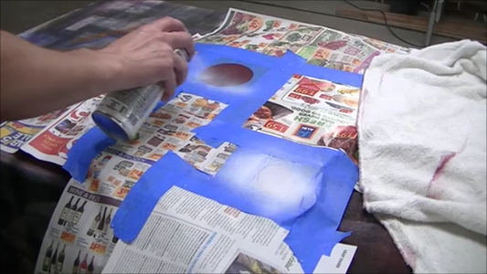

Its the same process for the white areas in the third shot you can see the impression left by tracing the template on to the tape.
Step 15:
Then mask off the surrounding area and spray the white paint.
Step 16:
Here is what it looks like after the white paint. In my opinion you could stop here, it looks pretty cool and has sort of a minimalist kind of look to the piece. Or you could keep on going and adding more detail.

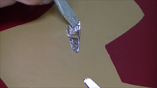

Since the eyes were so small I decided to paint them with a brush. Unfortunately the paint peeled.
Step 18:
So since the paint peeled I decided to scrape off the paint, it was pretty soft so it came off fairly easily, then sand the area and repaint it using a brush.
