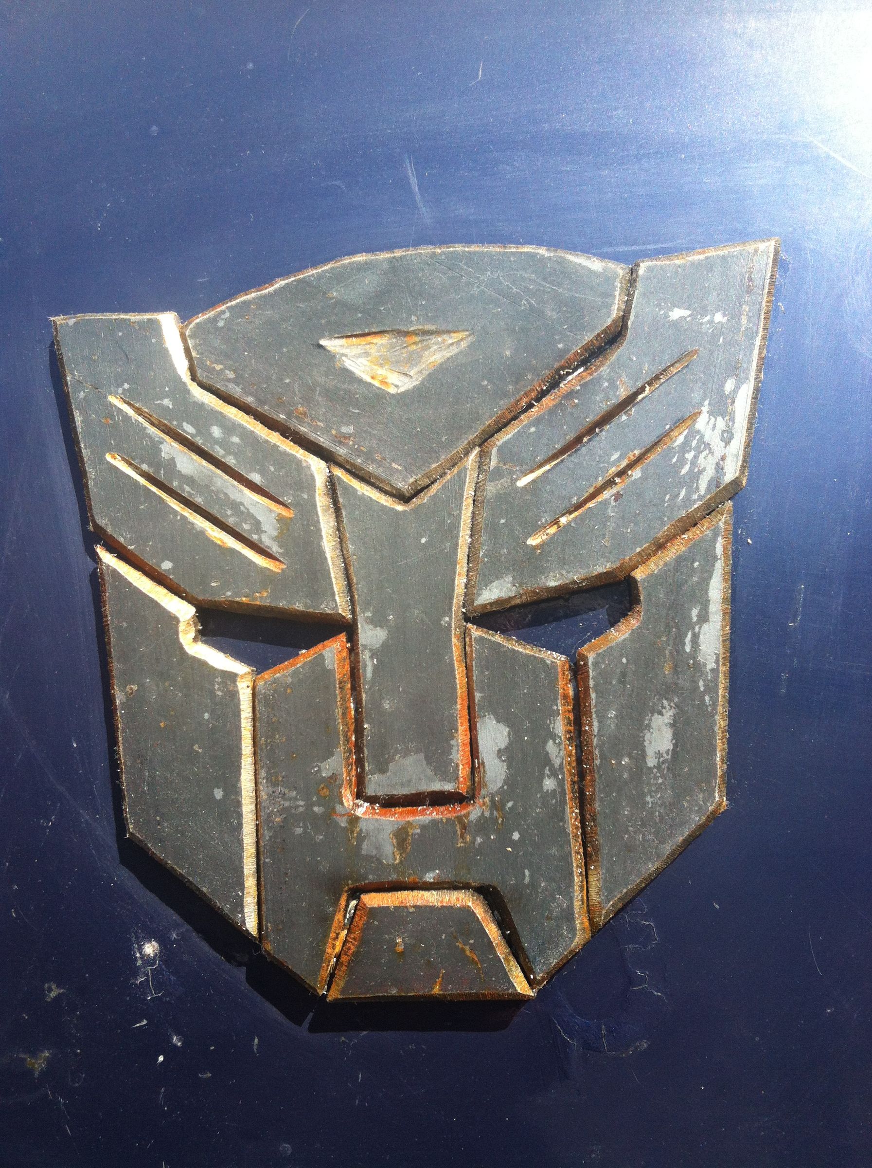

I like to teach myself to do things. If you're like me, finding a cool theme for a project to help sharpen a skill is always fun. I've recently started making custom "hero-themed" helmets and other cosplay-like elements that have rather practical functions for everyday life. I make these for myself and for other people. If this Instructable were to be selected for the Epilog Challenge VI, the Tech Contest Sponsored by little bits,or the Hand tools only contest, I absolutely use any prizes won from these contests to get this business idea off the ground and scooting with a bit of swiftness. I'd like to have a few more pieces of equipment for this venture before I make the website live and officially open for business, So again, any or all of the prizes up for grabs between these three contests would be a great help. That's enough of the "pretty-please pick-me" for now :) , perhaps more of that later.
I wanted to get better at welding thin gauge sheet metal, as well as other related metal processes. This Instructable follows some of my progress on a welding helmet I am making. An Ironman welding helmet. A Welded Ironman Welding Helmet. If Tony Stark were poor, A real person, socially awkward, and kinda "meh" with his math skills, we'd be the same person he and I.
