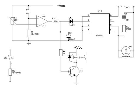

The circuit
The circuit is quite simple. P1 is used to set the level where the pump should start pumping. In dry soil the resistance of the spikes is high and the voltage on the inverting pin of the opamp is low. If that is lower than the voltage on the non-inverting pin (set by P1) the output will go high. This will activate the solidstate relay (a 39MF22) and or activate the mechanical relay. The PCB allows for both. The value of R1 is depending on your humidity sensor and the type of soil you use. For me 10 K was a good choice. In Step 4, where I describe the humidity sensor. I will tell you how to choose a good value for this resistor.
The pump that I use is a small submersible pump, used for small pond fountains. It pumps water from a container into a drip line in my veggie bed. Submersible pumps do not like to run dry, so we need some way to measure the waterlevel and to stop the pump when the level is too low. That is where S1 and R5 come in. S1 is a simple Normally Open float switch. I use a reed relay attached to the outside of the container and a floating device with a magnet on the inside (more about that later. When the level in the container goes too low, the float switch closes.
The trick is that I connect the floatswitch via a very small resistor (10-100 R) to the same terminals that the moisture sensor is attached to. So if the water level is too low, and the switch closes, there suddenly is a very low resistance over the humidity spikes and the 741 Op amp is 'tricked' into 'thinking' that the soil is wet enough and will switch off the pump.
You could use other switches than a reed relay, but this one has worked for me (I will come with some suggestions later)
C2 is not really necessary. One can put it in to give a bit of a delay with switchin the relay's on or off and thus avoid jittering.
The voltage to feed the 741 op amp is not so critical. Mine works on 5 Volts (I would not go much lower) but depending on the type of 741 you use you may go as high as 18 or 22 Volts. If you do though, you may want to recalculate R2. The current value of R2 is 220 Ohm.
In calculating the resistor value for other voltages, take the following in consideration: The 39MF22 has forward voltage of 1.2 Volts. Current should be between 5 and 20 mA. Most green or red LED's have a forward voltage of 2 Volts. Therefore the value of R should be at least (Vcc-3.2)/20 (gives value in kOhm) and at most (Vcc-3.2)/5 (gives value in kOhm).
So for 5 Volts this would be 1.8/20=90 Ohm till 1.8/5=360 Ohm

The snubbing network around C1 and R3 is optional and most likely not necessary as I understand solid state relays to be quite capable of handling inductive loads. If you use it, put it in the wall socket (more about this later)

Testing
Step 1
When the soldering is done test the board: insert the 741 opamp in its foot, but do not insert the 39MF22.
Take a piece of wire, possibly a piece that you cut off from one of the resistors, bend it in a 'U' shape and stick that in leg 2 and 3 of the IC foot of the 39MF22.
Set P1 in the middle position and apply power.
As there is nothing attached to the sensor input, the LED should light up. If it does not, turn P1 till it does (but really, it should already light up in the middle position).
If you are using a relay, measure if the relay really closes.
If you have come this far, things are looking good. Time for the next step
Step 2
Remove the piece of wire from the IC foot, (but leave it there if you are using a mechanical relay only)
Remove power
Insert your 39MF22
Apply power again
Your LED should be on, albeit a bit less bright than before.
If it does not light up then there are a few possibilities:
The value of the LED-resistor is too high and therefore the trigger current of the 39MF22 is not met
The value of the resistor was too low and you have burned out your 39MF22
Your 39MF22 was broken to begin with.
Check your resistor values and try again
Step 3
Attach your humidity sensor and stick it in the soil. Turn P1 till the LED just goes off. Pull your humidity sensor out of the soil. Your LED should be on again.
Stick your sensor back in the soil and turn P1 so your LED is just on. Water your soil around the sensor and check your LED, it should be off or go off very soon.
If that is all OK you are in business. If not, don't despair. It is a simple circuit and there really cannot be much wrong with it. check all your connections, inspect your PCB, did you make any shorts?

Step 9: Irrigating Your Garden With an Opamp: the Electrical Circuit
a 220 V line is interrupted and switched by the opamp circuit and led to a wall socket
The pump plugs into that wallsocket/
A moisture sensor goes to the opamp circuit
A levelswitch, attached on the basin, goes to the op amp circuit

Step 12: Irrigating Your Garden With an Opamp: Update
Ater having used the presented circuit with much success, i needed to make a more dedicated one for a strawberry tower.
I actually didnt want to fuss with a mains fed high voltage pump anymore, so I found the JT180-A. A 5-12 Volt DC pump for a relatively low price (7 euro). As the 741 can operate in that voltage range, there was no need for a relay, but it could be switched directly.
For the transistor one can take a 2n1613 or 2n1711 as wel, but it can cutting it very close with regard to the 150 mA collector current. I used it as I had it laying around, but it is relatively expensive at 65 cts (euro).
The BD 137 is a much safer option and even cheaper at 0.25 euro. the 2N1613 and 2N1711 would benefit from a cooling element.
Though not drawn, it might be wise to put a 100uf and a 100nF over the power line.
I presume the function of the Soil moisture sensor is clear. However, I added two other things in parallel to the sensor.
First there is S1. this is the float switch that closes when the waterreservoir is empty. If it closes the opamp will be fooled into thinking there is no need to pump, thus avoiding the pump to run dry.
The other sensor is a rain sensor. If the soil is dry, but it is aboutto rain, it seems futile to start irrigating. Again the rain sensor, like the float switch, will trick the op-amp into thinking the soil is wet enough and will not pump.
Depending on the Voltage used, one can decide to leave out the LED and lower the value of the base-resistor
