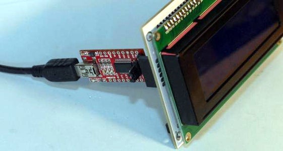

Step 2: Load Software on InvIoT U1
1. connect FTDI
2. install latest verstion of arduino IDE and the InvIoT library Download. Info on how to install can be found at InvIoT.com 'softare setup'. Manual for all the functions of the library, more examples, and help can also found.
3. on arduino IDE goto File->Examples->InvIoT->g.Applications->irrigation->Run first EEPROM upload
4. press upload and open the Serial terminal. This sketch uploads all the strings to the EEPROM. ATMEGA328 has a low memory size, and all the strings that are used will take up all the memory.
5. on arduino IDE goto File->Examples->InvIoT->g.Applications->irrigation->Program.
6. press upload to upload the final sketch to the InvIoT U1. You are done uploading the software. Work with the menu and test the pins D2,D3,D5,D6. Those are the 4 pins used for the 4 valves. Every module is different
