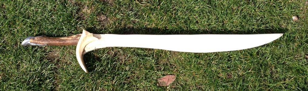

I decided to recreate a movie prop from The Hobbit, directed by Peter Jackson. The design was made by Paul Tobin and I suggest you take a look on some other designs that was made for this movie prop.
To make it safe, the blade is made out of foam AND hot glue! The movie version of the sword has a handle made from a dragon fang. I do not have access to a dragon, so I used a deer's antler instead, btw. said deer got rid of that by himself, and he is still perfectly alive. If you want to recreate this instructable I suggest using wood instead (it was a pain to use the antler).

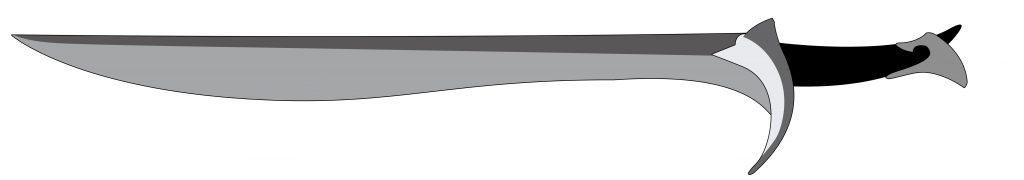

First I took a screengrab from the movie, where the sword is clearly visible and I traced it in Photoshop (actually it was its free online clone photopea). I wanted the sword to be at least 900mm long, and I don't have a plotter, so I split the outlined version on multiple A4 sheets and saved it as a PDF. I attach this document, so you can use it yourself!
Logically the next step was to glue all the papers together, to form a blueprint.

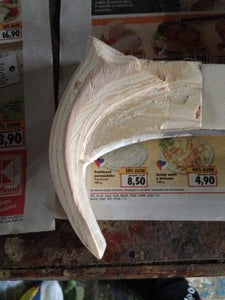

I transferred the shape of the guard, to the plywood I had laying around. I cut the basic shape with a bandsaw and chiseled the rest of the shape. The Center of the guard was drilled, so the fiberglass core can be put through.

Step 17: Finished!
Thanks for reading down here! Making this prop was quite a journey for me. I hope, this instructable entertained you and I would be humbled if it even inspired anyone.
