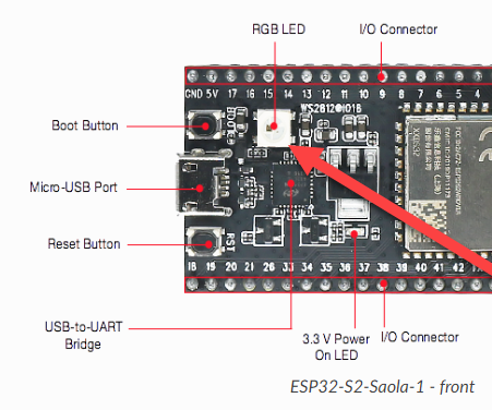

Step 4: Solder the Contacts on the Potentiometer to a Piece of 3 Wire.
I used some Cat 5 I had lying around, I just stripped three wires, one for positive, negative and signal. Then I soldered the wires to the Potentiometer.
Step 5: Add the Wires to the 8266
Once you have the Potentiometer soldered to the wire, then move the other end of wire to the 8266. Hook the 3.3v to the positive wire, the ground to the ground and finally the signal wire to A0..
