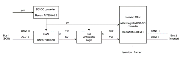

Our Formula Student vehicle’s motor controller uses isolated CAN for its control. However, our ECU does not support isolated CAN. For that reason, in order to protect our Low Voltage system from High Voltage (in case of a malfunction in the motor controller) and to further improve the signal integrity of the CAN bus (eliminating noise due to the switching pulses of the inverter) we decided to design and implement a CAN repeater.

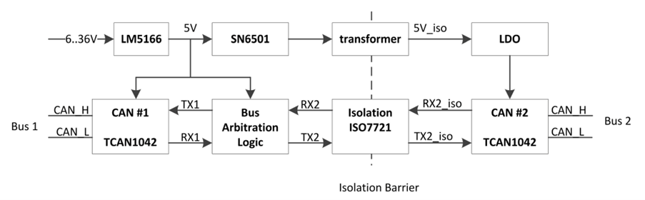

Step 1: TIDA-01487 Reference Design
The basis for the design of this CAN repeater is the reference design “TIDA-01487”, courtesy of Texas Instruments. You can find more info on this reference design here: https://www.ti.com/tool/TIDA-01487. The main differences between the TIDA-01487 and our design can be discerned by the block diagrams above(on the left, the TIDA-01487 design and ours, on the right).

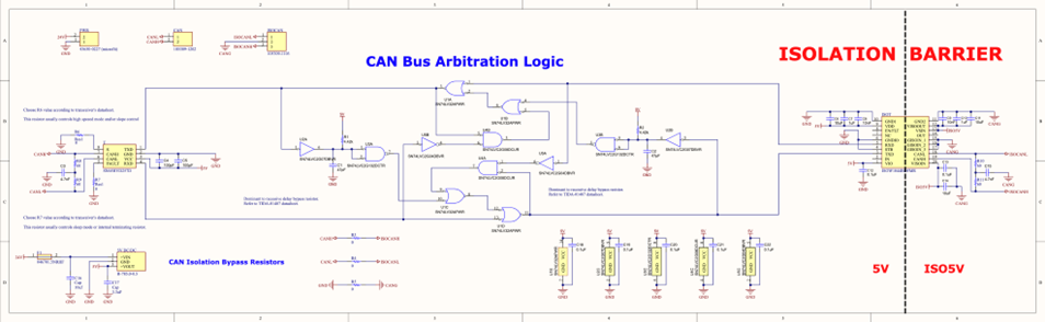

Step 2: Schematic

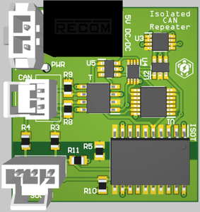

The CAN repeater consists of :
1 x SN74LVC2G132DCTR Dual 2-Input NAND gate
1 x SN74LVC2G08DCUR Dual 2-Input AND gate
1 x SN74LVC2G07DBVR Buffer
1 x SN74LVC2G04DBVR Dual inverter
1 x SN74LV32APWR Quadruple 2-Input OR Gates
1 x SN65HVD257D CAN transceiver
1 x ISOW1044BDFMR Isolated CAN FD Transceiver with Integrated DC-DC Converter
1 x R-785.0-0.5 24V to 5V DC-DC converter
0805 Resistors, 0805 Capacitors and connectors according to the schematic
Last but not least, 1 x Custom CAN repeater PCB
