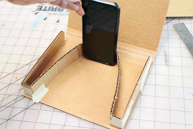

The type of material that you use to make your rough mock ups, will depend on the shape and volume of your product ideas. Paper, cardstock, poster board, and cardboard will work for most things, allowing you to create the appearance of solid masses (using patterns - think of a cardboard box) and flat planes.
RESOURCES: For those new to making patterns for shapes, the Dutch website, Template Maker, is a great resource for looking at basic shape patterns. For those that have 3D modeling experience, there a free downloadable software called Pepakura Designer that turns your 3D designs into a foldable pattern.
If you are designing something that is solid with surface undulations or cut through sections, using blue or pink insulation foam is a quick way rough out the shape without having to figure out a paper pattern. I will be adding a link to an instructable on how to model using blue foam, so check back in a few weeks!
The following are images of my own rough prototyping process. I chose my favorite ideas from my sketchbook and using the supplies listed above, brought them into the physical world!
Remember, they don't have to be pretty. The job of rough prototypes is to get a feel for form, scale, and basic function.

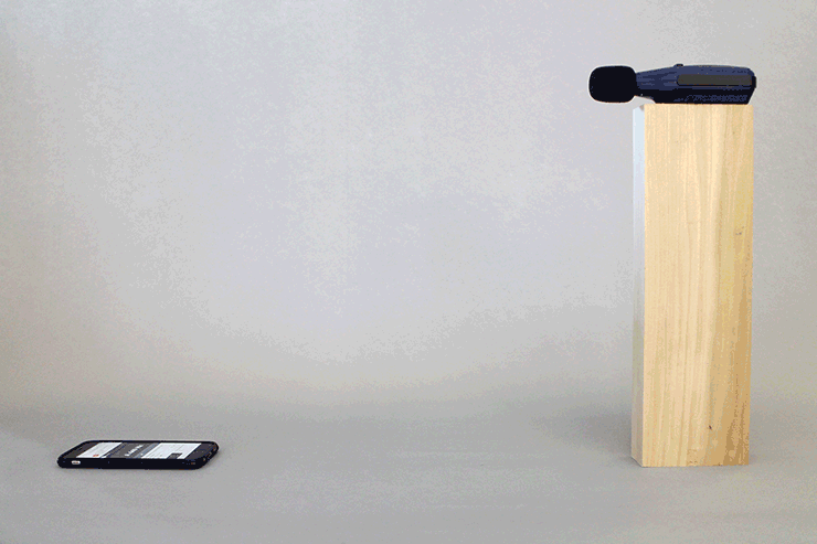

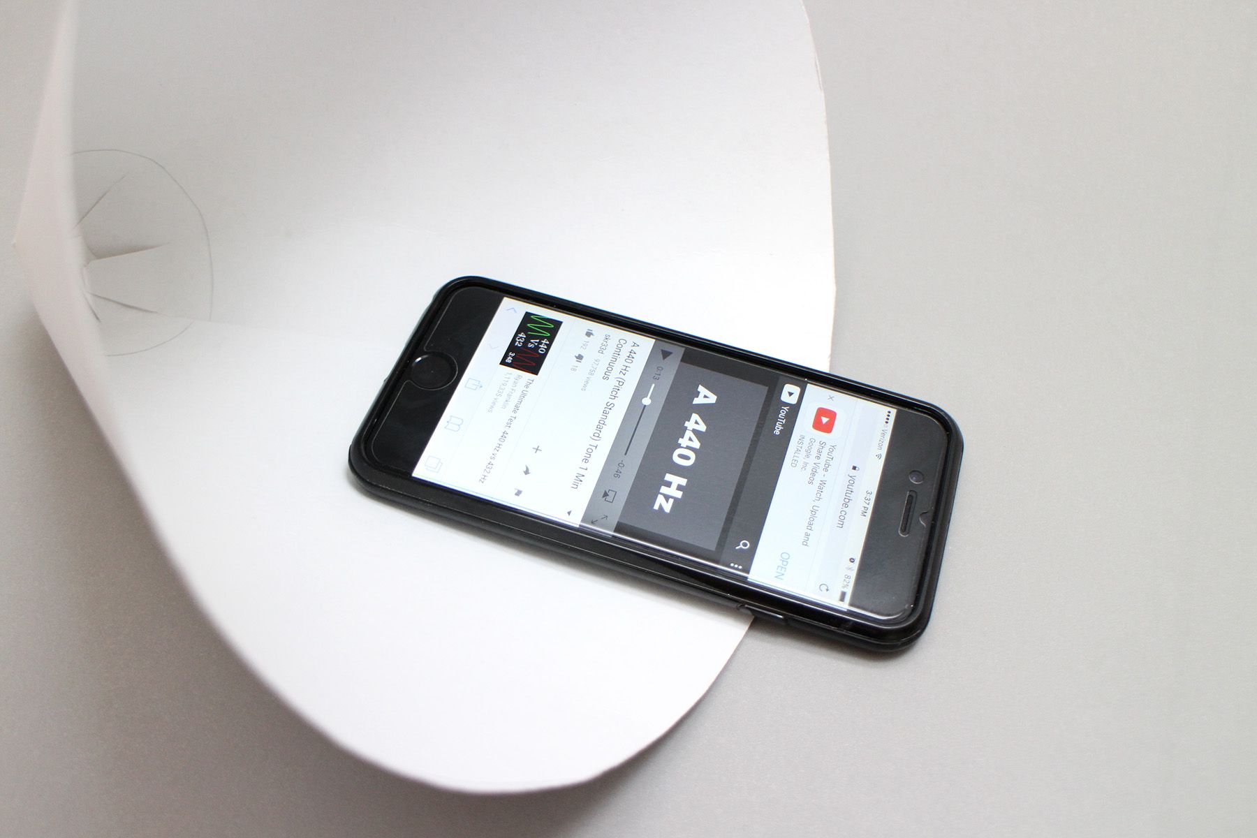

From there, I picked my three favorites and did a decibel meter test using a constant tone coming from my phone:
The cone and nautilus shapes both had the best amplification, and since I found the nautilus to be the most engaging/beautiful form, I chose that design to move forward with.

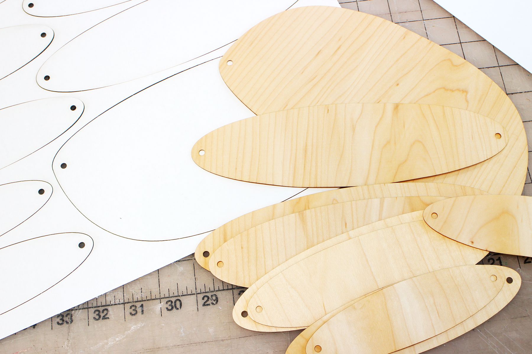

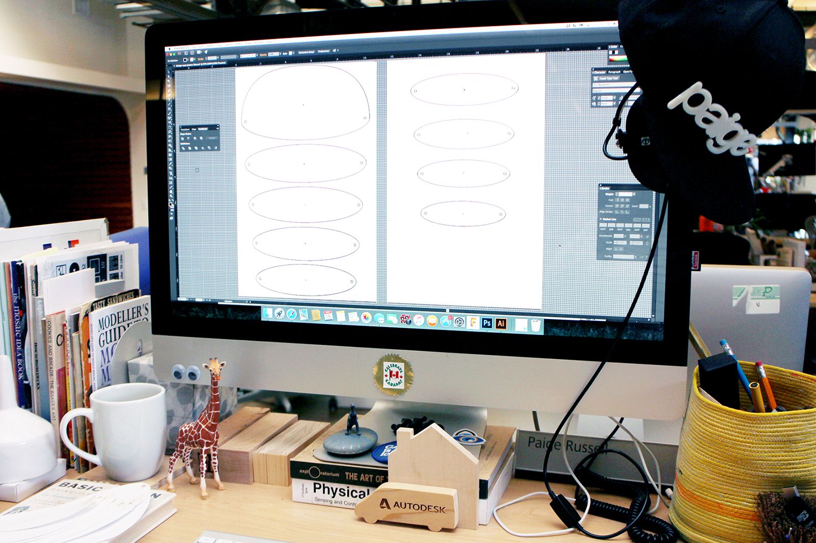

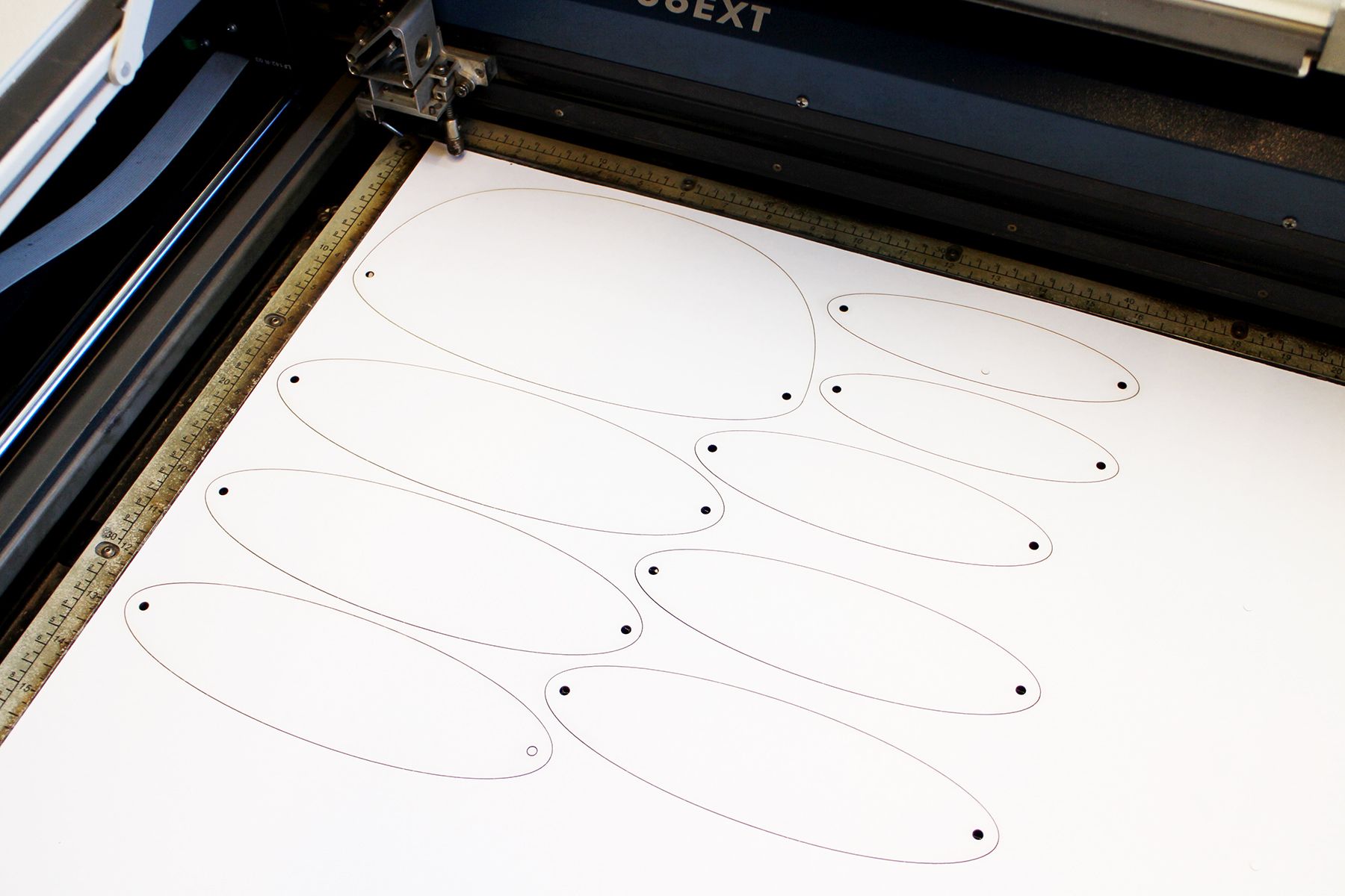

To make my refined models, I scanned in the rough pattern I'd handmade in the first round of prototyping, then traced and cleaned them up in Adobe Illustrator.

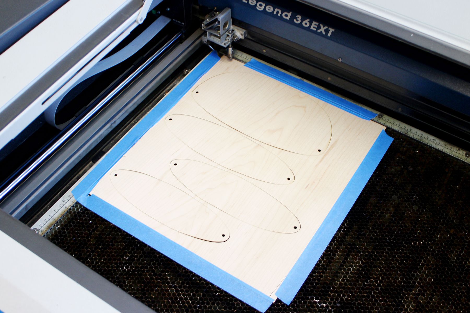

Having these vector based pattern pieces allowed me to then head to the laser cutter and cut my next pieces more quickly and precisely.
REMEMBER: There are great online services like Ponoko that will laser cut pieces for you, and Shapeways for 3D printed parts, if you don't have access to either of those rapid prototyping machines.

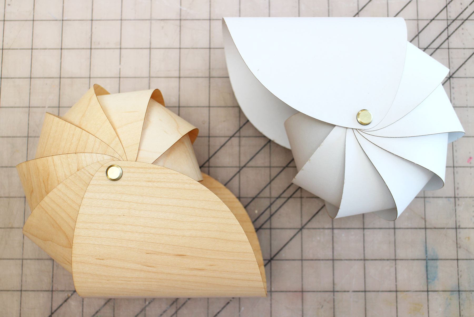

After more amplification and user testing, the wood veneer is the winning material, as it creates a warm sound, offers good amplification, and is so good looking!
