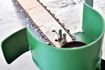

We first did this experiment for multiple reasons such as to see if the angle grinder could really work as a chain saw, whether the angle grinder is burdened, if it gets warm and if it can be used as a last resort in case of an emergency. Therefore, our work starts making a metallic plate, on which the angle grinder is adapted and stabilized when necessary. On this metallic plate, we placed a metallic rail taken from an arboricultural factory as well as the chain and the gear of the particular machine. The chain that we placed on the metallic plate is revolved on a high speed without derailing its way supported by the gear that revolves the angle grinder at the particular time. This metallic rail has the potential to move towards and backwards as a result to enable us to set how tight or loose we want our chain to be.
Then, we made a protective cover around the chain close to the parts that we place our hands in order to reduce any danger. Thus, without any special difficulty the angle grinder 4 is a fact!!!!

After completing it and testing it, we got amazed by its performance as an electrical chain saw. Although, we consider that this was a transformation of a high risk. Also, we must say that using a bigger angle grinder, the performance will be dramatically increased. However, the advantage of this transformation is that none of the components is modified as a result they can be easily returned unchanged to their primary position, where they were placed at the chainsaw.
