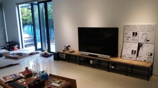

Here's a modular TV console-bench, which I made out of IKEA components, inspired by the trendy wooden-top tables with steel frames that are in all the expensive design shops these days.
As our TV wall is really long, I designed this as 3 separate benches that can be moved around as needed. The middle bench supports the TV, sound-bar and all our media equipment, and the other 2 can become 2-person benches for extra seating.

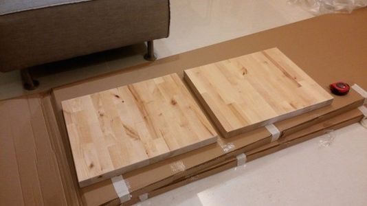

BIRCH BLOCK BOARD for the Console tops
- I used 1 x IKEA NUMERAR counter top (246x60cm x3.8cm thick) because it was the cheapest solid wood available in town, by far. I got this cut down into 6 pieces, each 50x40cm.
- I used a friend’s tablesaw, and a router to round off the edges. After cutting the 3 pieces I had very little waste left over.

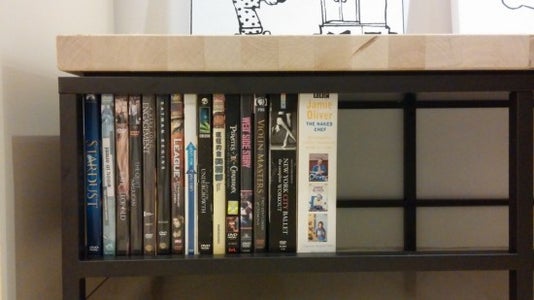

Position the laminate shelf in the centre of the birch top, with an even margin of birch panels all around. Screw through the laminate shelf to the birch panels. Need 4 screws per panel, and all the hardware is completely hidden.
Just flip this birch top+laminate shelf assembly over, and place it back on top of the VITTSJO frame. The laminate shelf should fit back in perfectly, ‘locking’ the birch top in place. It also creates a lovely ‘floating gap’ detail between the VITTSJO frame and the birch top.
Stain or varnish as desired. I like this as-is, but I might want to stain it a Teak colour to match my other furniture in the future.

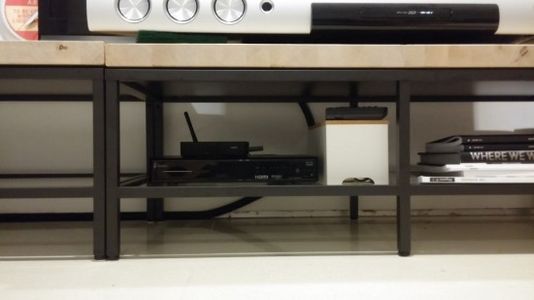

Wiring up the console: I managed to hide all the cables in a cable management box (KVISSLE, also from IKEA), and with a couple of lengths of black cable management tubing. It turned out surprisingly well, after about an hour of cable wrangling. Look, no cables!

Grab a beer and enjoy some TV!
Since this is a 3-module console, and only the centre module is ‘wired up’, I am able to move the 2 side modules around as desired as extra bench seating when I have more people over. The frame has a slight sway to it, but with the birch top to distribute the load evenly, it definitely is strong enough to hold 2 people per bench.
