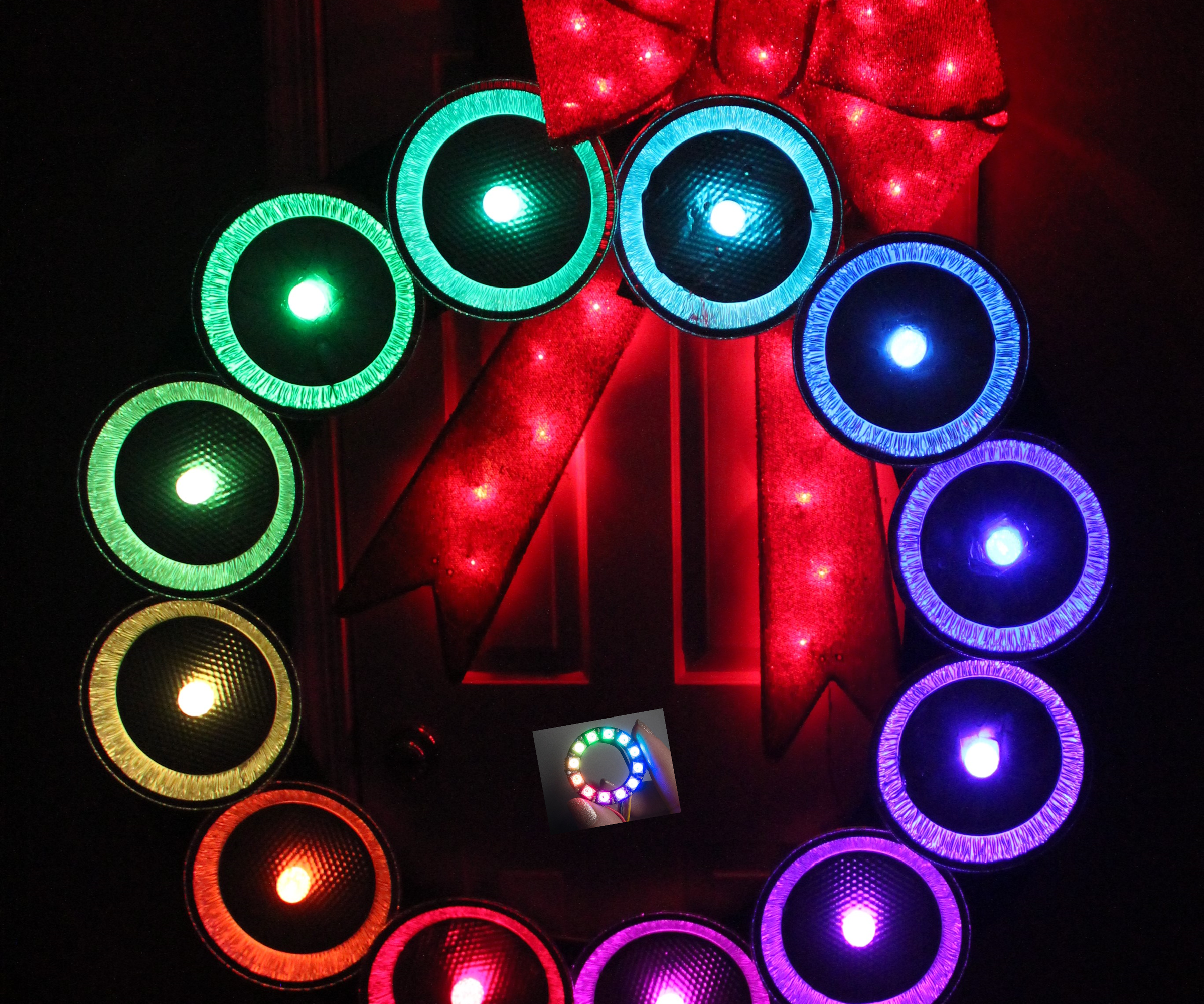

The pie tin reflector "hack" has been used by DIY hobbyists for many years. The pie tin Christmas Tree is the most common example, which may have been popularized in a 1950's how-to article (eg; Popular Mechanics?). If anyone has more pie tin reflector history, please let me know.
The general idea is to find a way to insert the light bulb through the center of the pie tin as shown. Typically you start with a holiday light string that allows each individual bulb to be removed from its base. You then place the bulb through a pie tin and backing board, both with appropriate sized holes to allow the bulb to be re-inserted into the base. This basic approach must be adapted for different types and brands of holiday light bulbs.
Pie tin Instructables from me include the Christmas Tree, Hanukkah Menorah, New Year's Eve Time Ball, Holiday Wreath, and now the Great Pumpkin.

The Hefty or Reynolds E-Z Foil Pie Pans for 9-inch recipes look great as reflectors for the GE Color Effects bulbs. These 9-inch pie tins are the ones with the 8-point "star" shape in the middle. The smaller 8-inch pie tins have the "hub and spoke" design in the middle. I am recycling old pie tins, so I am not quite sure where I got those. I believe they are Jiffy Foil 8-inch pie pans (see Amazon) or equivalent.
The E-Z Foil 9-inch pie tins are actually 8-3/4 inch inner diameter (inside the rim), which allows spacing them exactly 9-inches apart in this project. Using an X-Acto knife or equivalent, cut a 1-inch diameter hole in the center of each pie tin. I usually use a Washington quarter or a dollar coin as guide for cutting the center hole. A total of 12x9-inch pie tins are used in a circular pattern resembling a giant clock.
The seven smaller 8-inch pie tins are prepared in the similar manner with center holes.
