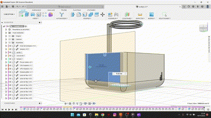

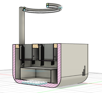

Step 4: Fusion360
////// This step is not finished yet//////
