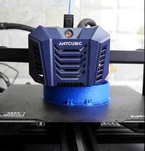

Step 7: Slicing
Download the below stl file and by using any of your favorite Slicing software, slice it. I have used Prusa Slicer and the following are the details that you are looking for
  1. Bed Temperature- 60C (Room Temperature- 10C)
  2. Nozzle Temperature- 210C (Room Temperature- 10C)
  3. Support- Yes(Organic)- On build plate only
  4. Infill- 15%
  5. Nozzle- 0.4mm
  6. Layer height- 0.2
If you need to edit the 3D model of the same please comment, and I will share the step file :)
Step 8: 3D Printing
3D Print the slice model and here are the details that you might need:
  1. Material- PLA+
  2. Time to Print- 3hr 49min
  3. Material weight- 45.36g

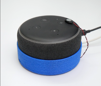

Step 9: Assembling
The assembly is very straightforward, just follow the circuit diagram and you are good to go. The only thing you have to keep in mind is to connect the Power cable and the speaker at the end by inserting their wires from the circular holes provided. Rectangular holes are for the microphones of the Offline Voice recognition module. There is a slot provided inside on the back of the rectangular holes section and that's for the Gravity connector.
Place your Alexa Echo Dot Gen 3 on the top and stick the speaker on one of the 4 microphones of the Echo Dot as shown above.
Step 10: Enjoy!!
You are good to go to do wonders with your JARVISified Alexa!!
