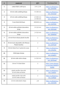

Prepare the parts according to the given dimensions

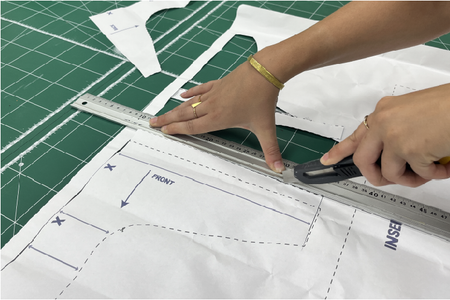

print the attached pattern, note that there is cube for comparing the print size.
cut according to the cutting mark.

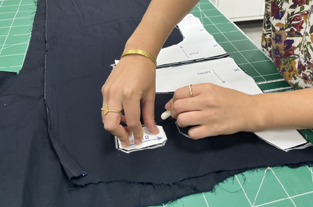

Attach the pattern to the fabric and mark the cutout on folded fabric - cut the fabric accordingly.

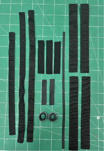

cut all the strips according to the given measurements

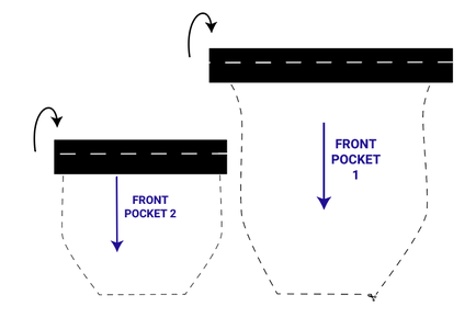

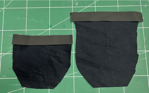

Connect the 2 short decorative stripe to the 2 POCKET part - the stripe folded in 2 and warp the edge of the fabric
Step 3:
Connect the long decorative strip to the FRONT part at both ends, and make a square of attachment 50 mm long every 100 mm to create toys hung
Step 4:
Connect the POCKET1,2 part to the FRONT part

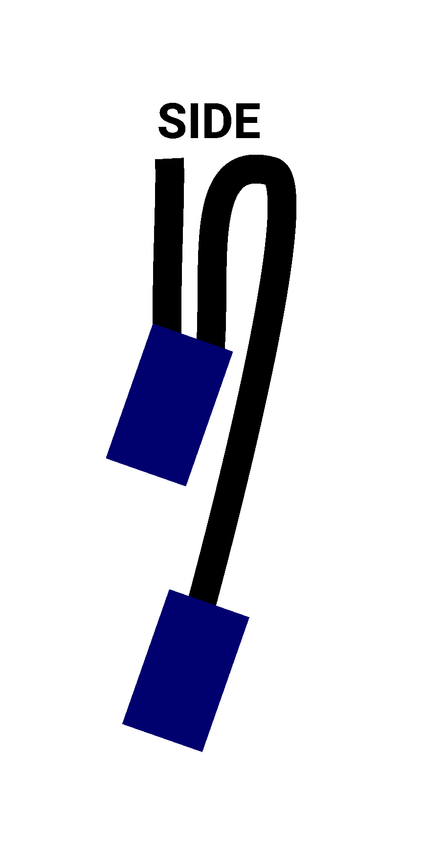

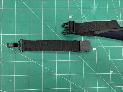

permanent straps X2
connect the pipe clamps to the Oval ring Buckle Loop
than attached the loop to a 35 mm strap at the edge of the strip leave 40 mm gap to make strength sew.
attached the dual-adjustable side Release Plastic Buckles - make sure that you connect 2 different part of the buckles to each strip
*Reminder - put the buckles so that they are opposite
