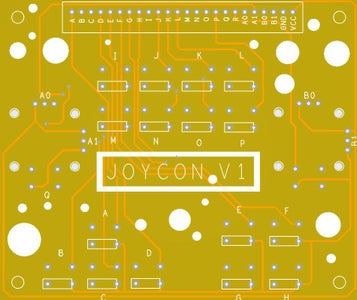

Step 1: PCB Design
The Joycon Board is a straightforward PCB that acts as a breakout board for buttons and analog sticks.
Each button is wired to the header pin and GND and works in a pull-down configuration. Also, the analog pins of the joystick are connected with both VCC and GND, and the middle pin of all potentiometers is connected with header pins as well.
A 24-pin header connector, which will be used to mount this board on a breadboard, connects each button.
This board's design is also straightforward, with four buttons on the left D-pad, four on the right D-pad, and the other eight buttons located in the center.
Additionally, two analog joysticks are positioned on the board's left and right sides, just above the D-Pad.

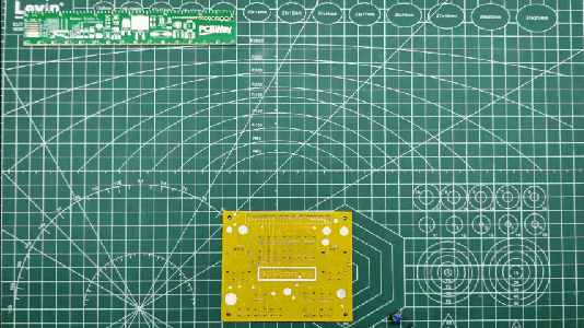

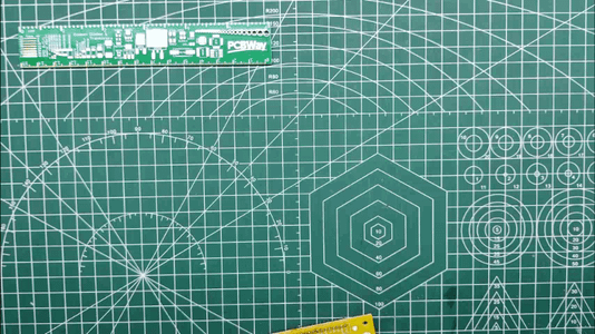

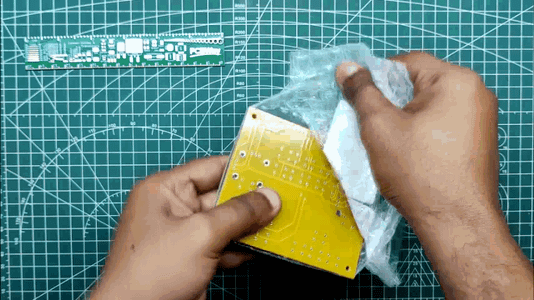

Step 2: PCBWAY
I finished the PCB design and exported the Gerber data, which I then forwarded to PCBWAY for samples.
A PCB order for yellow soldermask with white silkscreen was placed.
PCBs arrived in a week, which was quite quick.
As for the quality of the PCBs, each PCB was produced properly, and there were no faults or misprints anywhere.
Overall quality was super and I recommend you guys for checking them out if you need great PCB service for less cost.

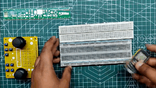

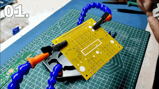

Step 3: Board Assembly
  • To begin assembling the board, we first install each button and analog stick individually on the PCB

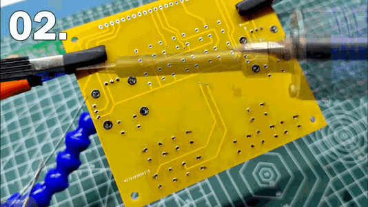

  • Then we flip the board over and use a soldering iron to connect the pads of all the buttons.

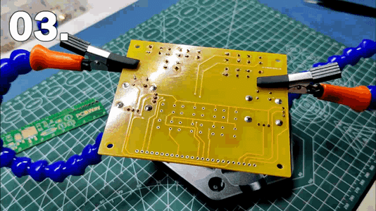

  • We attach a header pin connector to the bottom side before flipping the board once more.
  • Using a soldering iron, we solder the header pin pads on the board's top side.

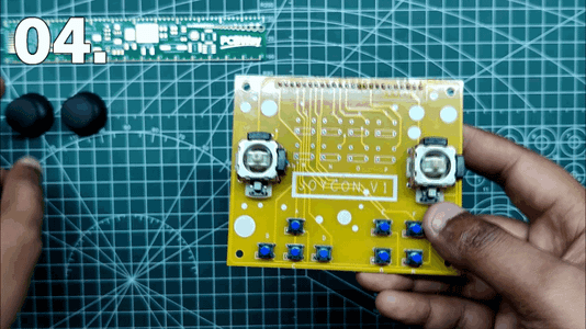

  • At last, we add Analog Joystick Thumb Cover to both joysticks.
Step 4: RESULT of Board Assembly
This is what came about once the board was put together.
We can utilize this configuration to control things like a servo motor or create a game controller.

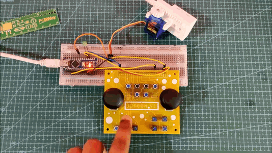

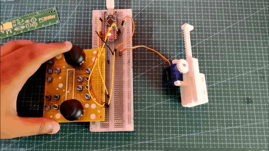

Step 5: Testing
Considering that this board is a button breakout board, we can use it to control LEDs or even read button presses.
#include <Servo.h>
Servo myservo; // create servo object to control a servo
int potpin = A0; // analog pin used to connect the potentiometer
int val; // variable to read the value from the analog pin
void setup() {
myservo.attach(6); // attaches the servo on pin 9 to the servo object
void loop() {
val = analogRead(potpin); // reads the value of the potentiometer (value between 0 and 1023)
val = map(val, 0, 1023, 0, 180); // scale it to use it with the servo (value between 0 and 180)
myservo.write(val); // sets the servo position according to the scaled value
delay(15); // waits for the servo to get there
By reading the joystick's pot value and adjusting the servo position in accordance with it, we can even use joysticks to drive servo motors.

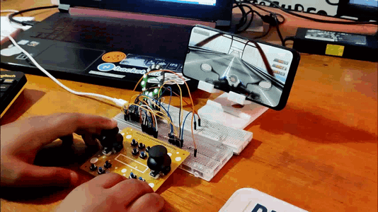

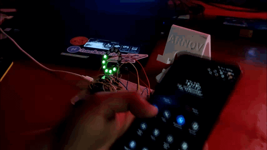

Step 6: Game Controller Implementation- ESP32 Game Controller
Here's an awesome way of using this board: making a wireless game controller by using an ESP32 development board and some jumper wires.
In accordance with the circuit shown above, we connect the ESP32 to every pin on the Joycon.
There are a total of 12 buttons used, including 2 analog stick buttons and 10 regular buttons.
Additionally, 3.3V and GND are connected to VCC and GND, respectively, to power the analog stick potentiometers.

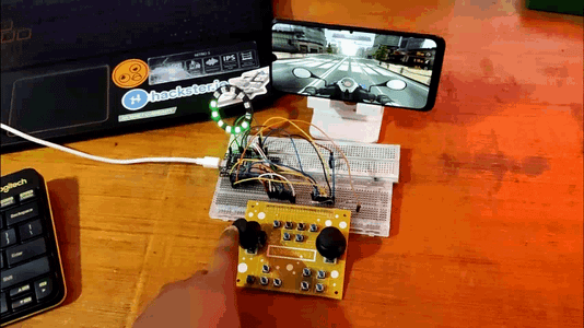

Step 8: Result
The game is currently being played through Bluetooth with a game controller.
We must supply this controller with 5V of power in order to connect to it.
Once the ESP CONTROLLER is connected to our smartphone through Bluetooth, we can load any game that accepts controller input and have it function immediately.
There are some problems with this controller that can be fixed by making a small change to the code, which is a project for later.
