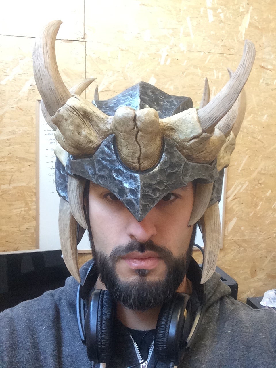

To assemble the helmet, I used two part epoxy. This step required some dremeling of the horn/ teeth parts to fit back into place. I also sanded down to the bare plastic to ensure good adhesion.
12 horns/teeth later, it was ready to try on! It fits well but i'm still thinking about adding some low key padding to the inside or maybe some fur lining.
