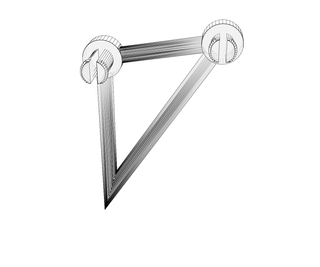

Step 2: Print the Parts
3d print these files

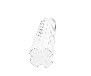

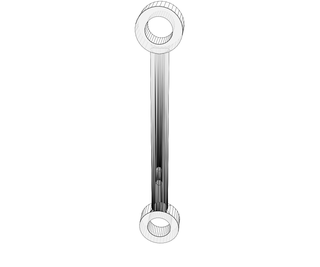

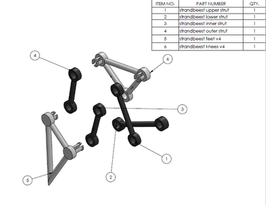

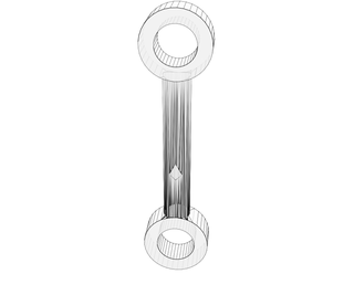

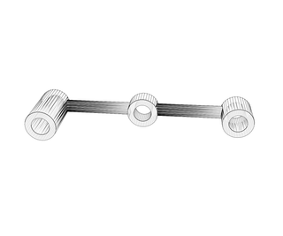

Step 6: Assemble the 3D Printed Components
Assemble the 3D printed components as shown in the diagrams
(note: some components may require sanding/drilling out holes further for proper tolerances, and some components of the crankshaft assembly may need to be glued into place depending upon tolerances after printing)

Step 8: Assemble 3D Printed Components Onto the Box
Place the 2 threaded rods through the 2 outermost drilled out holes on the project box, such that the amount of threaded rods coming out of both sides of the box are equidistant.
Slide the each of the leg assemblies onto the threaded rods, and fasten the crankshaft components to the servo horns. (note some components may require some fine tuning of spacing and tolerances for proper operation)
Add 1/2-20 nuts to the end of each end of the threaded rods, such that the components will remain in place.
