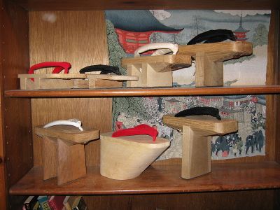

I made some older Japanese style Geta around a year ago for some cosplay at an anime convention. They were a bit of a rush job, I made them in under 24 hours, and only had time to use 1/4 thick piece of rope for the hanao (basically the thong part of a flip-flop). I finally have had time to make some proper hanao that are way more comfortable then just nylon rope. If you are unfamiliar with what Geta are you can find a lot of information on what they are and the history of them here: http://en.wikipedia.org/wiki/Geta_(footwear).
I'll be using a lot of Japaneses terms throughout this article so if you need to feel free to reference the Wikipedia article above.
It does take a little bit of practice to learn how to walk in these and you will feel the burn in you calf muscles after a few hours, but they are great for improving your balance, especially if you make some of the tengu geta, I may try making some in a future instructable but all I have to go off of are pictures.

Hanao - the thong on the Geta
Ha - the teeth on the Geta
Dai - the board on the Geta that the foot is on
Most Geta are made from paulownia a light weight wood, but mine are made oak just becasuse it was easier to obtain.
