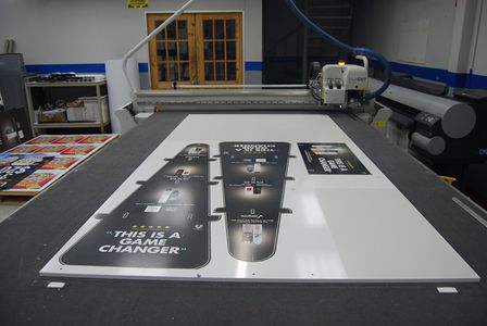

The branding was printed on adhesive vinyl and applied to 12mm PVC sheet. 1 sheet of PVC provided for 1 display unit. The registration marks (black dots) allowed the ESKO multi-cutter to accurately cut the parts out based on the print locations.
For ease of assembly there is no glue necessary and no pockets or edge treatments. I wanted the parts to be easily repeatable on a CNC router without issues of the bed's levelness affecting an edge-treatment or pocket depth.
