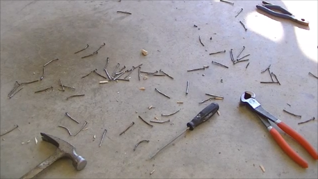

Here I made sure to pull all the nails from the 2 x 4s. The second pic shows the tools I used and the aftermath. Its important to double check all your wood and pull all the nails because they will be getting trimmed on the table saw later. You don't want to damage or wear out your saw blade by cutting a bunch of nails.

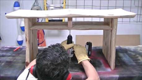

In this pic I am pre-drilling for screws that will eventually be used to attach the legs to the bench top. I did a dry fit first to locate all the screws and then used glue and screws for final assembly. I also drilled some shallow 1/2 inch holes that would later be used to cover the screw heads with 1/2 inch dowel plugs.

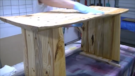

Now it was time for staining. Since this was pine I decided to use some "pre-stain" to prep the wood for the actual stain. By this point I had sanded the entire piece with 80 grit sandpaper, 150 and 220. And I have wiped off all the dust and cleaned the piece. Once all this is done then I brushed on the "pre-stain". I wait about 10-15 minutes and then with a clean cotton rag wipe off any excess "pre-stain".
