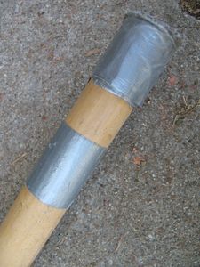

Step 5: Optional: Duct Tape to Protect Ends and Prevent Splitting
To protect the ends from splitting, I put duct tape around them. On the bottom side, I put a lot of duct tape to make booties.
