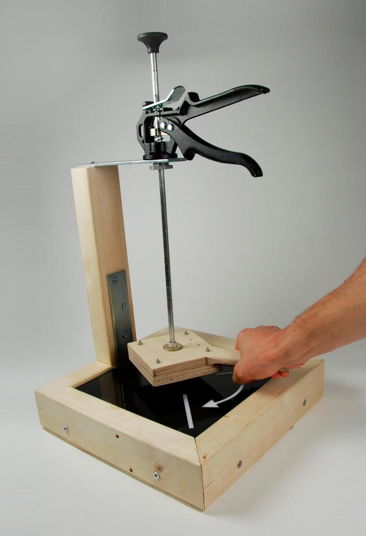

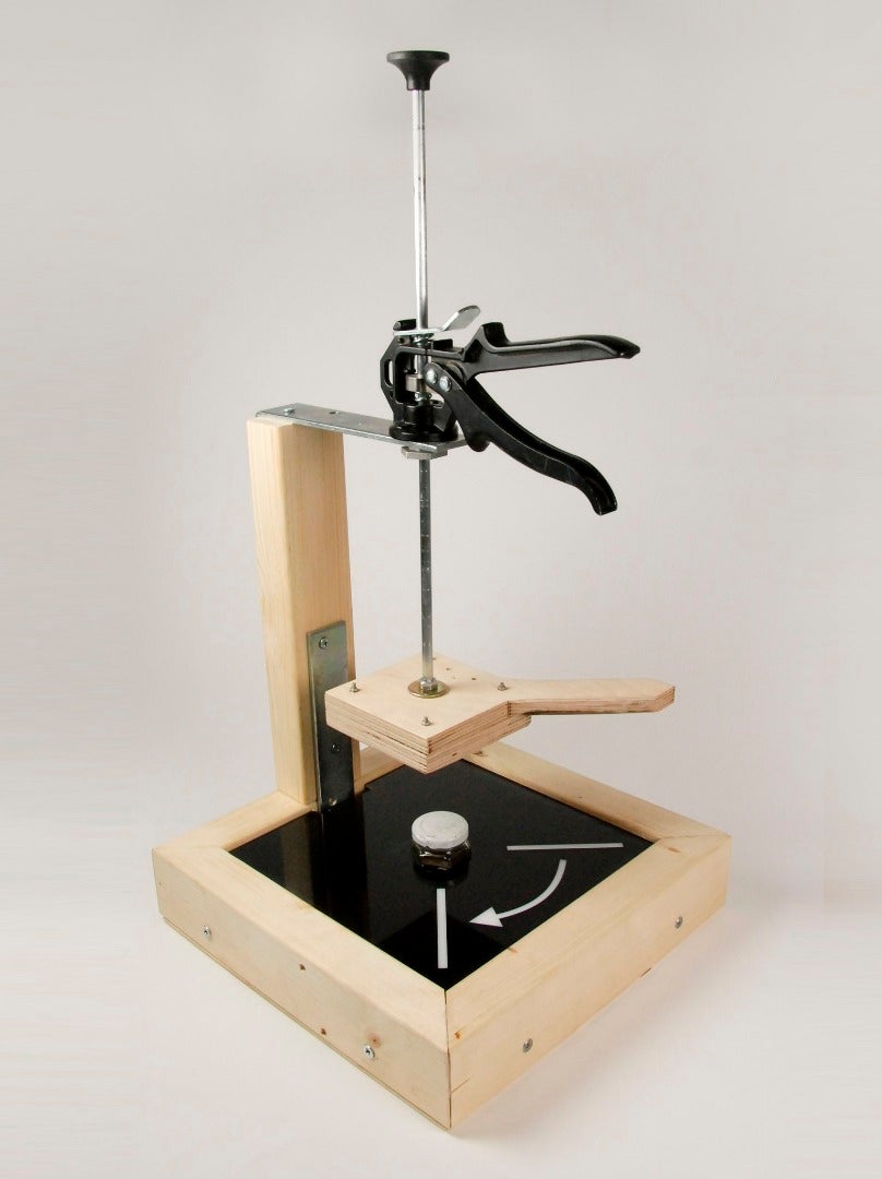

Jar Closing Aid is a DIY assistive tool to close jars without damaging the lid or the pot and without the need for high strength of the user. The aid is easy to reproduce, adapt and that can be made with everyday accessible tools and materials (wood, a silicone gun, screws, sawing machine, etc.)
Note that this aid works only for non-circular jars (square, hexagonal, etc.)

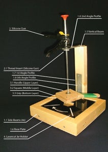

The assistive tool exists of 4 main parts, which are also shown in the pictures:
1. The Base Frame
2. The Silicone Gun System
3. The Handle
4. The Lasercut Jar-holder
In this instructable we describe how each of these parts can be made.

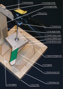

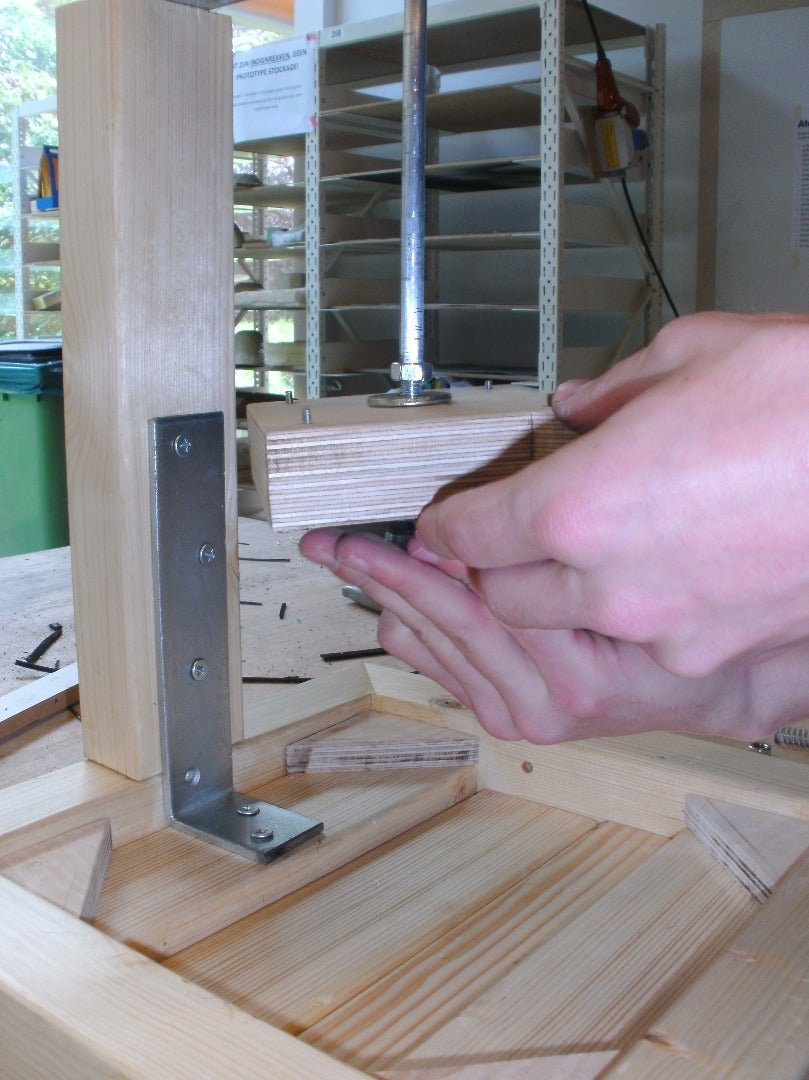

Step 12: Assembly of the Frame (1)
Now the base-frame (including the baseplate and the square frame) and the angle profiles are all ready, the frame can be assembled. This step is rather easy and happens by screwing the parts together, using the angle profiles.
_______________________________________
The first angle profile (1.8) fits in the baseplate (1.6) and should be screwed to the beams (1.1 - 1.2) in the frame and the upright beam (1.5).
The second angle profile (1.9) needs to be connected also with the upright beam (1.5), so the thread insert (2.1) comes in the center above the frame.
The third angle profile (1.10) comes on the inside of the upright beam (1.5), attached to the reinforcement beam (1.2)
Check the pictures for the right positioning of the angle profiles...

The handle (3) is made of 3 layers:
- the upper layer (3.1) which contains the real handle and is made out of 15mm thickness multiplex
- the middle layer (3.2) in which the nuts are hidden, a square piece made out of 15mm thickness multiplex
- the bottom layer (3.3), existing of a material that creates a lot of friction/grip.
The first step to make this handle, is sawing the wooden upper layer, middle layer and 4 triangles.
To saw these parts, we used again a bet saw because of the ability to saw free forms.
The upper and the middle part have dimensions as in the sketches above.
Out of the restants of the multiplex plate of 15mm thickness, four triangles (1.7) should be cutted out (sketch).
This triangles will later sustain the jar holding plate in the frame.
All parts can be sanded for a better finishing.
When the user is weaker, the handle can be made longer or be customized for better comfort.
Also another shape or type of handle can be used. We used a standard, simple handle in our prototype.

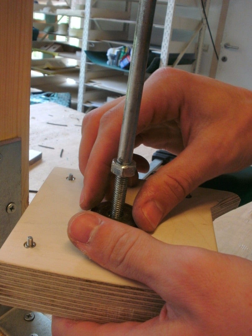

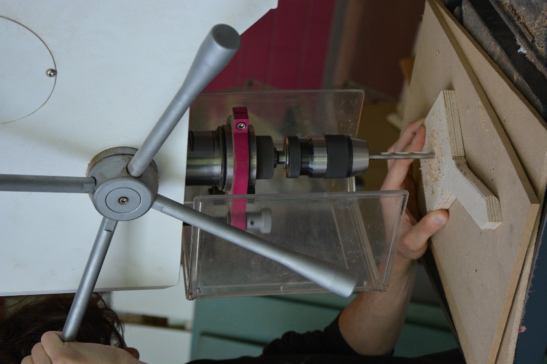

Step 14: Drilling of the Holes in the Handle (3.1 & 3.2)
To attach the layers to each other and to attach them to the frame later on, some holes for bolts are needed.
Center of the handle (upper layer 3.1):
This layer needs a hole with a diameter of 10mm in the center, through which the silicone pistol will fit.
Center of the square (middle layer 3.2):
This layer needs a hole with a diameter of 20mm in the center, in which the nuts will be hidden.
Small holes through both layers (3.1 & 3.2):
After having drilled this hole, the two parts should be stacked so they fit perfectly. Now the small holes should be drilled through both layers, so the holes match perfectly. In this step, we used a 3,5mm drill (to use M3 bolts and nuts afterwards). The position of these holes can be chosen freely, but should be on the outside and evenly distributed (to keep the parts together well).
Drilling a sink for the bolts:
Afterwards, the holes can be drilled partly with a bigger drill, so the M3-bolts sink in it and the surface is flat.

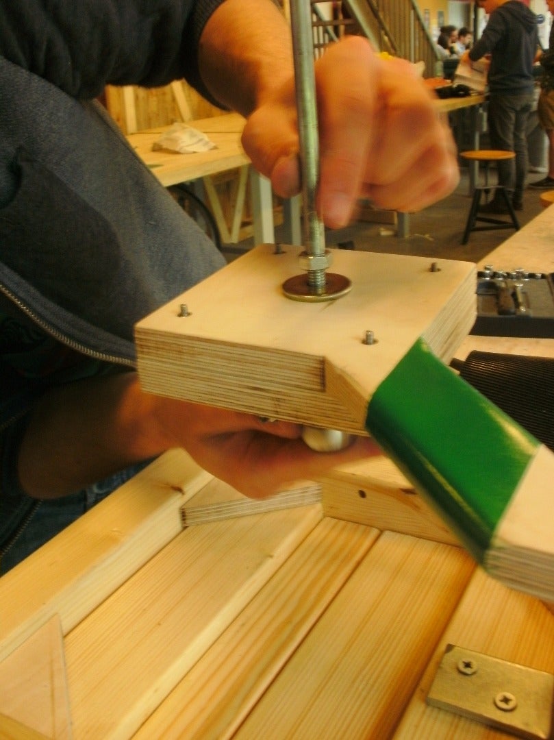

Step 16: Assembling the Wooden Parts of the Handle (3.1 & 3.2)
Once all the holes are drilled, the parts can easily be assembled.
We used M3 bolts and nuts to assemble it, so disassembly and replacing parts is possible.
Screws, glue or a bigger piece of wood with a hole in it are also possible solutions for making this handle.
We positioned the bolts and nuts in this way that the nut is on the upper side...
This makes assembly a bit easier and excludes damaging the lid of the jar while using the aid.

In order to keep the nut operable and reachable to tighten it when necessary, we made a hole in the grip material.
The hole was made by hitting a drill through the sheet of grip material (picture).

Step 20: Adding the 4 Triangles to the Frame (1.7)
Some restants of the frame can be mounted now...
To sustain the jar-holders well and high enough, the 4 triangles created with the restants of the wood should be glued in the inner corners of the frame. Also beam (1.3) and (1.4) from the first steps can be placed in the frame definitively.
Step 21: Assembly of the Handle With the Silicone Pistol (2 & 3)
The finished handle should be mounted with the end of the silicone pistol.
The rod of the silicone pistol has a threaded lower end which is normally M8.
To create a strong conection with the rod, the handle will be clamped between three M8 nuts.
First, one single M8 nut should be turned onto the rod.
Then a ring should be pushed onto the rod so the upper side of the handle cannot be damaged.
Afterwards, the handle can be mounted on the rod and secured with two M8 nuts.
Make sure that all of the nuts are well tightened so the handle is well connected.
A socket spanner can be used to tighten the bolts hard enough.

Step 25: How to Use the Jar Closing Aid
Step 1. Put the jar in the jarholder with the lid laying on the pot
Step 2. Make sure that the handle is in the start-position
Step 3. Let the handle fall down on the pot by pushing the yellow handle
Step 4. Press the black silicone gun once, so the force to close the pot is generated
Step 5. Now turn the handle from the one stripe to the second stripe (arrow)
Step 6. Lift up the handle again while pushing the yellow handle
Now the pot should be closed!
This aid is mainly useful in sheltered workshops and for people with certain limitations like upper limb impairments or people that have only one hand left... Hopefully this aid can help people and allow them to close or open jars again.
