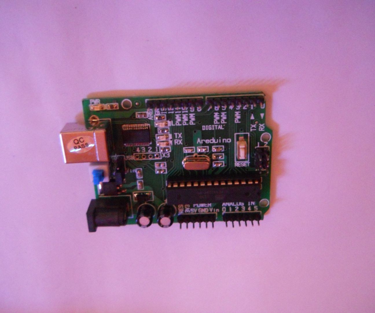

The project is fairly simple in terms of the things required.
- Arduino
- Bluetooth Module (Preferably HC-05)
- LEDs (For prototyping) x 4
- BC-547 transistors x 4
- 10k and 150 ohms resistors x 4 each
- Relay Board (Optional, only if you are serious about installing Jarvis in your home)
- Power supply (I used a powerbank and a 9V battery)
- Wires and Breadboard
- An Android phone or tablet with an Internet connection
