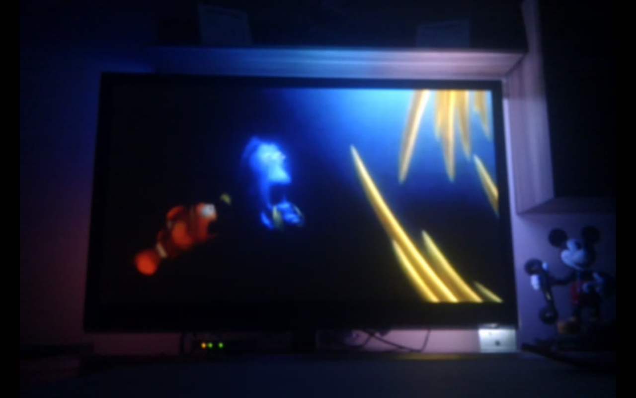

This instruction is intended to explain a simple and cheap way to build your own dynamic LED Ambient Light.
First of all I want to let you guys know that my English is not that good (I am from Germany, so... ). But I guess you'll understand enough to follow these instructions. I think my results are pretty cool, so I let you guys know how to rebuild this stuff.
If you want to see the final result check out this video:

Step 2: Overview
The first half of this instruction set will explain everything concerning the hardware of the project. In the second half I will explain how my Java application can be used to control the LED strips.
But first I would like to give a brief overview of the whole assembly.
The provided application takes a screen shot of your display. That image is divided into different parts. The right and left part of the screen and the upper part, which is also divided into one left and one right part. That makes four parts altogether.
The application calculates three mean values for each of these areas (Red, Green, Blue). By doing so we can combine those values to one mean color for that part of the screen.
After we calculated four of those colors (for each area one) we can send them to the micro controllers.
The computer and the micro controllers are connected via serial connection.
After the micro controllers (in my case two Arduinos) received their messages they can change the color of the LED strips. Therefor they change the PWM value of their output pins. Each of these pins is connected to a transistor that switches the externally powered 12V LED strips on and off.
