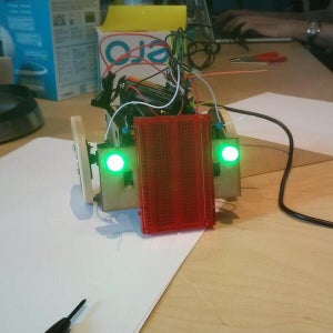

Pictured, "phantombot" a Sumobot Jr at JSFest
