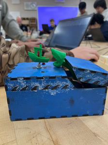

This useless box is inspired by two users on Instructables, OrangeKat and Phoebister. The design we went for was similar to Phoebister's design, with the slanted configuration for the lid. The difference that we intend on doing is making it look like jaws with a Benchy (boat/dingy) as the switch, and the hand being the shark mouth. The box itself is ocean themed, with dark blue waves, making the rest a lighter blue. Once the DPDT switched gets flicked a little animation will happen, the lid would go up and starts playing the Jaw's theme song. This will repeat 2 more times, then the shark will come out and attack the boat, flipping the switch back.

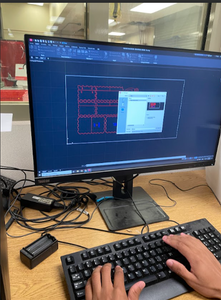

Step 2: Using Inventor
We planned out the design of the box using inventor, to make sure everything worked, we notice the box had a couple of flaws so we redesigned it. Once we made the changes in inventor we put it on AutoCAD and later printed it out.

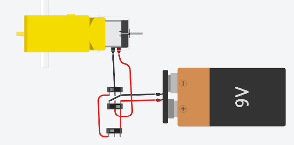

Step 3: Planned It Out on Tinkercadd
Using Tinkercadd we illustrated what our components and circuits will look like, until we were happy with it.

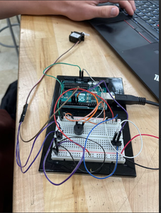

Step 4: Actual Circuitry
Once we finished the circuitry on Tinkercadd, we built it on our breadboard and Arduino. We did have a small issue with the code and wiring, but after some trouble shooting we got it working.

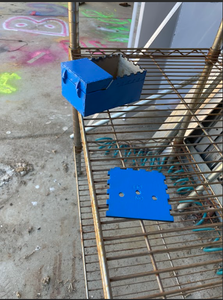

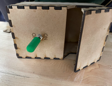

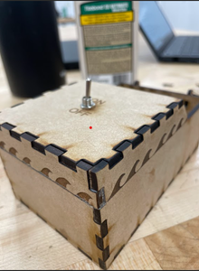

Step 5: Cutting Out Box Draft
At the same time we used Phoebister design. We used our laser cutter to cut out the box. We had a small hurdle with that the laser printer, that it wasn't differentiating our cut lines with our heavy engraving lines. We restarted the program and redrew the lines, and it worked out. We used AutoCAD to design, draft and edit Phoebister design.

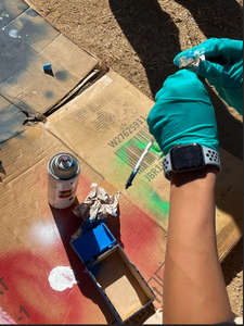

Step 6: Painting
Due to lack of materials we couldn't get a good thin paint brush, so what we made a DIY paintbrush where we ripped off a napkin, and stuck it down a plastic straw, and made the tip of the napkin really fine. Once we got over the paintbrush hurdle we spray painted the box and painted white waves on the box.

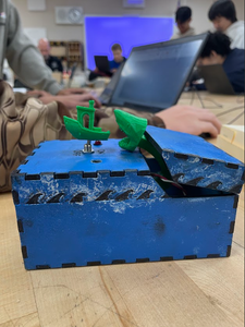

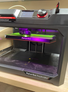

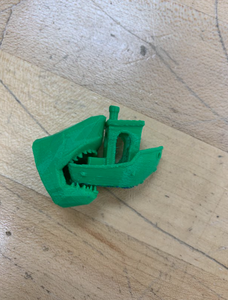

Step 7: 3D Printing

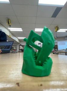

We noticed that the parts that assemble the useless box would fit, but the inside of the box would be disorganized with parts all over the place. After noticing, we 3d printed out holsters for our components, limit switch and motor. We also used our time to 3d print a boat, commonly referred to as Benchy, we also printed out a shark head and an arm to mount the shark head .

Step 9: Putting It Together
Once we got all of our parts together we had one thing left to do, that was making the Useless Box work. Some issues that we came up with was someone among us misplacing the shark head forcing us to print another one.
