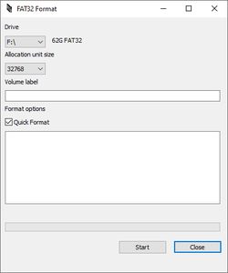

  1. Important: The SD card must be formatted as FAT32, or the ESP32-S3 won’t be able to read it properly.
Formatting SD Cards
Windows won’t let you format cards larger than 32GB as FAT32 by default, but don't worry, there's a free and easy workaround.
Use the GUIFormat Tool:
  1. Download the tool from https://fat32format-gui.en.lo4d.com/windows.
  2. Insert your SD card into your computer and take note of what letter mount it used (such as /E)
  3. Launch the guiformat.exe program.
  4. Select your SD card’s drive letter.
  5. Set:
  6. Allocation size: 32K
  7. Volume label: whatever you want!
  8. Quick Format: ✅ Checked
  9. Click Start. It’ll format the entire card as FAT32, even if it’s 64GB or 256GB.
  10. Remember the key limitation of fat32 is that no single file can be bigger than 4GB
⚠️ Double-check that you selected the correct drive letter, this will erase everything on that card! ⚠️

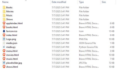

Required Folder Structure
Here’s some examples of how you can layout your SD card:
/Movies
/Interstellar.mp4
/Interstellar.jpg
/Shows
/The Office
/S01E01 - Pilot.mp4
/S01E02 - Diversity Day.mp4
/The Office.jpg
AND / OR (you can have both styles based on how you layout your folders, its per show entry)
/Gravity Falls
/Season 1
/S1E1 - Tourist Trapped.mp4
/S1E2 - The Legend of the Gobblewonker.mp4
/Season 2
/S2E1 - Scary-oke.mp4
/S2E2 - Into the Bunker.mp4
/Alex Hirsh Interveiw.mp4 (this is a single episode that will apear next to the season folders)
/Gravity Falls.jpg
/Books/
The Martian.pdf
/Music/
River of Dreams.mp3
AND / OR
/Music/
/Billy Joel
/River of Dreams.mp3
AND / OR
/Music/
/Billy Joel ---> (artist)
/Glass Houses ---> (album)
/You may be right.mp3
AND / OR
/Music/
/Jackson Studner
/Playlist1
/If you could read my mind.mp3
/Playlist2
/Hey Jude.mp3
(You can name the two directory levels whatever you want, and place music at any level so its fully customizable to whatever you want to do)
index.html
appleindex.html
menu.html
movies.html
shows.html
books.html
music.html
gallery.html
files.html
favicon.ico
A downloadable SD card template is included in the GitHub repository. You can download that directly to your SD card to get started. It includes sample media you can use to test before gathering all of your real content.

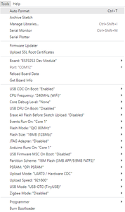

Now configure the board under the "Tools" Tab, look for the following settings towards the bottom and set them as follows:
  1. Board: ESP32S3 Dev Module
  2. Port: Select the correct COM port once the device is plugged in
  3. USB CDC on Boot > Enabled
  4. Flash Size: 16MB (128Mb)
  5. Partition Scheme: 16MB Flash (3MB APP/9.9MB FATFS)
  6. PSRAM: OPI PSRAM
  7. Upload Speed: 921600
  8. USB Mode: USB-OTG (tinyUSB)
⚠️ These settings are based on the Waveshare 1.47" display model, other boards may need adjustments. Also check the picture of the settings above. ⚠️

  2. Wait for the compile and upload process to finish.
  3. If successful, you’ll see a “Done uploading” message.
  4. Check the serial output to see if everything launched correctly. There will be debugging logs for your convenience.
If you get errors, make sure the correct COM port is selected and the board is seated properly. Try pressing the boot/reset button on the ESP32 if needed during upload. For missing library errors
A guide for this ESP32 board can be found at This Link, it may help troubleshooting.
You can also check to see if anyone has had similar problems, or open a new issue on the github here.
If you need to get the ESP32S3 back into Flash Mode:
You can manually put the device in flashing mode if Arduino IDE stops picking it up on serial. This can happen if you need to re-flash the code at any point, as once Nomad is loaded, the device will no longer accept flash writes unless put into Flash mode. If you can access the web server, you can simply click "Flash Mode" in the admin panel. If you can't access the web server, you can do it with the two onboard buttons by holding the BOOT button, pressing the RESET button, then release the RESET button and then finally release the BOOT button. The screen should go dark, or say "Flash mode".
Editing the screen UI
  1. You can change what displays on the screen, currently it displays a SD usage bar, the current SSID, # of connected users, and WIFI/SD card status.
  2. Editing the screen will involve downloading Squareline studios and using the free version to edit the files in the github.
  3. This isnt super beginer friendly, but you can find docs for squareline online and the project files are avaiable on the github under /docs.
Library issues:
  1. If you encounter an error while flashing along the lines of: fatal error: <libraryname>.h: No such file or directory
  2. It usually means your libraries are the wrong version. I recommend cleaning out everything in your library folder (usually C:\Users\<yourusername>\Documents\Arduino\libraries on windows) and updating with just the required ones.
  3. Then try to re-flash, it should work.

Clean Folder Structure
Nomad depends on a specific folder and file layout to function properly. Here’s what it should look like:
/Movies
/Interstellar.mp4
/Interstellar.jpg
/Shows
/The Office
/S01E01 - Pilot.mp4
/The Office.jpg
/Gravity Falls
/Season 1
/Season 2
/Gravity Falls.jpg
/Books/
The Martian.pdf
/Music/
track01.mp3
AND / OR
/Music/
/Artist1
/track01.mp3
AND / OR
/Music/
/Artist1
/track01.mp3
/Album1
/track02.mp3
AND / OR
/Music/
/PersonName
/Playlist1
/track01.mp3
/Playlist2
/track02.mp3
