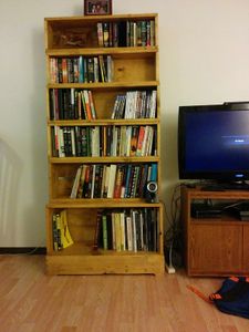

This design is based on a design I read about in Roy Underhill's Woodwright's Apprentice book. Thomas Jefferson used bookshelves in his house that could double as boxes for quick transport. In Underhill's book, the boxes are dovetailed together with a miter on the front corner to add a bit of design elegance. I wanted to make something like this, but I tend not to go all out when I'm making something for myself, so I thought I'd simplify the design a bit. I read a few different articles and landed on making the main box with a rabbit joint joined by cut nails. Why cut nails? Well, they grip wood better and they look cooler.
So that's basically all these are, a bunch of rabbeted, nailed together boxes. They all have backs of some sort, but are otherwise not fancy in any way. Most of my bookshelves are 24 inches across, but I wanted them a little wider, so I opted for 30 inches.
The other part of the design is simply getting together some books and deciding on heights and depths. I took my biggest big book and a couple other sizes and guestimated what I would need. For my shelf, I decided I wanted one big one at the bottom at 12" tall, 10" deep; a couple medium sized ones at 8" tall, 7" deep, and a small shelf at 7" tall, 5" deep. I ended up adding one more medium at 10" tall, because I underestimated a bit. That actually worked, though, to just make a few, see what I had, then add what I needed. My depths are all just based on standard board widths from the big box. So the 10" ones are made from 1x12s or whatever. You are lucky to get 10" of width on a 1x12 these days... I recommend seeing what's available in the big box and just fit what's there to what you have. You don't want to do a lot of ripping and making a bunch of extra work for yourself for no reason.

I made mine with pine, so finish options are pretty varied. Really, pine looks fine even without finish. You could just let it age naturally no problem. I decided to do just a couple coats of Danish oil. There is storebought Danish oil, or you can make your own (1 part boiled linseed oil, 1 part mineral spirits or turpentine, 1 part polyurethane). I used some storebought type with a dye in it, just to try it. For that one I also put a layer of amber shellac on top. It looks fine, but the other one I did just standard Danish oil and I think it looks better. You could also use milk paint, spray paint, lacquer, old fashioned soap finish. Really, you can do whatever you want, have fun.
Step 9: Setting It Up
Set up is simple. You put the base down then stack the boxes up, matching the letters you marked while fitting to ensure a stable fit. I tried using dowels on some shelves to see if that improved stability or anything, but it ended up being an unnecessary hassle, so I wouldn't recommend it. If you are worried or want some extra stability you could try something like that, or use a flat steel tie to join the shelves. I haven't found it to be necessary, but I don't have a cat. You could also join them together with a couple of screws (1 1/4" would work best) through the top of one and the bottom of the one above it. Try it out, see what works for you.
