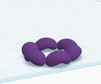

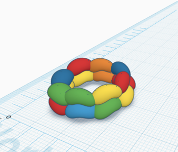

With the concept clear, I moved into Tinkercad, a beginner-friendly yet powerful tool for 3D modeling. Tinkercad’s interface allowed me to search for pre-existing “bean” shapes. I found several that could serve as the foundational geometry for my jelly beans.
Here’s what I did:
  1. Opened a new workspace and searched “bean” in the shape library.
  2. Duplicated the shape multiple times—each bean representing one “candy.”
  3. Adjusted the curvature and angle of each bean to form a perfect circle that fit around my ring finger.
  4. Scaled the beans to approximately 1 cm long each—small enough to be wearable but large enough to show texture.
To ensure a snug fit, I measured my finger circumference (around 17 mm for the inner diameter). This precision reflects an important concept from our course: parametric design, where measurable constraints guide aesthetic and functional choices.
When satisfied with the ring’s form, I grouped all the beans together into a single object and exported the file as an STL. The STL format preserves the model’s geometry and is the standard for 3D printing.

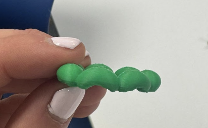

The next stage was preparing the design for printing. I imported the STL file into Bambu Studio, a slicing program that converts 3D models into printable instructions (G-code).
Here’s the setup process:
  1. Imported the STL file and oriented the ring flat on the build plate.
  2. Chose PLA filament—a biodegradable, easy-to-print material ideal for jewelry prototypes.
  3. Adjusted the layer height to 0.16 mm for fine detail and smooth curves.
  4. Added minimal supports to maintain the circular structure during printing.
  5. Sliced the model to check estimated print time (around 25 minutes).
In our coursework, we explored how material properties influence product design. PLA’s smooth finish and low melting temperature made it a perfect match for a colorful, candy-like look. Additionally, slicing software demonstrates the principle of digital fabrication workflow—translating digital form into physical reality.
After confirming settings, I exported the G-code and sent it to the Bambu printer. Watching the machine methodically build each jelly bean layer by layer was like witnessing digital craftsmanship come to life.

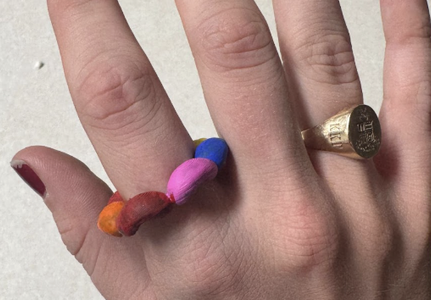

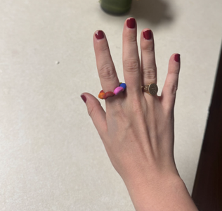

Once the ring was printed, I removed it from the build plate and carefully detached the supports with a file. The raw PLA surface was smooth enough to paint directly, though a light sanding gave it a more uniform texture.
I used acrylic paints to transform the plain print into a rainbow of jelly bean hues—reds, oranges, blues, pinks, and purples. Painting by hand gave the ring a handcrafted charm that balanced its digital origins.
At this stage, the piece evolved from a prototype to a final artifact. The process embodied a concept from our readings on hybrid craftsmanship—the merging of digital tools and human touch.
Each color choice added personality, turning the object into both an accessory and a conversation piece. The final look captured exactly what I envisioned: playful, bright, and unmistakably sweet.
