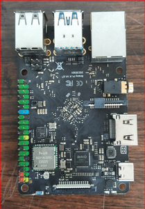

Brainy PI
Ethernet cable/wifi
Sd card/ hard drive

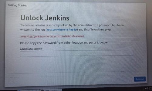

2. Next, we need to retrieve the initial admin password. you do that by command
sudo cat /var/lib/jenkins/secrets/initialAdminPassword
The password will be in format of
9df8c9c4cf694754a0047771a53b9fe8
3. To access the web interface go to your favorite browser and search
[BRAINYPIIPADDRESS]:8080
This will open the web interface of Jenkins
In the first window, it will ask for the Administrator password to unlock the jenkins. Here you to give the password which you retrieved earlier.

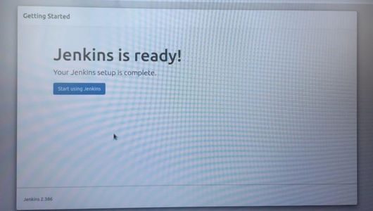

Step 5: Jenkins Web Setup
1. The next screen will ask you if you want to install the suggested plugins or select them for yourself. For this guide, we are just going to click the “Install suggested plugins” button
2. Next, you will be asked to create an admin user to interact with your Brainy Pi Jenkins installation fill in the details then click on continue the process.

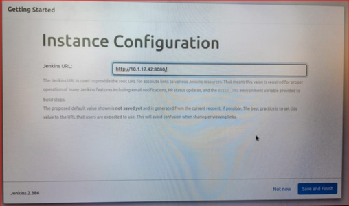

3. The next tab will ask you to verify the URL it has generated for your Jenkins installation. This URL should be your Brainy Pi’s IP address followed by the port number 8080.

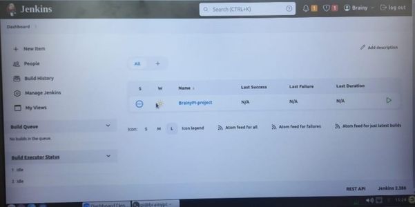

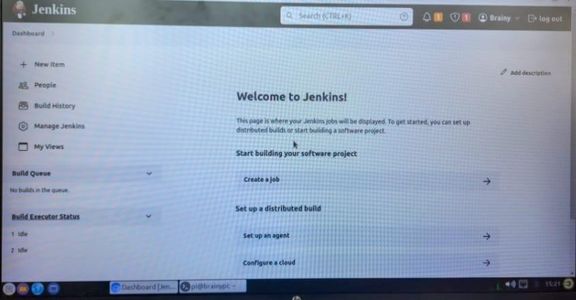

Step 6:
After this next process will take time around 5 mins then it is ready to use
Now Jenkins is ready to use you can explore the web interface and create jobs and other stuff
