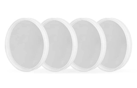

-Silicone Coaster Molds (4)

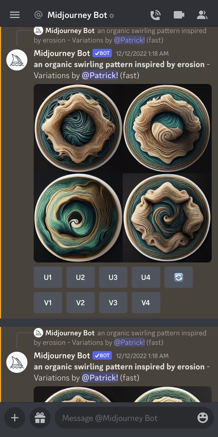

Step 2: Midjourney, Adobe Illustrator, Rhino, & Grasshopper
To develop and execute our visual concept our team Midjourney AI, Adobe Illustrator, Rhino 3D, and Grasshopper. Midjourney was used to develop initial concepts for our line patterns which were then traced as continuous paths in Illustrator. These lines were imported directly into Rhino and connected to Grasshopper which we used to control the robotic arm and dispenser.
