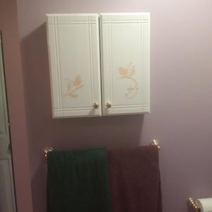

Step 4: Painting the Doors & Varathane
Painting the doors is easy but to add a little fine detail to the finished cabinet I decided to add a decorative bird stencil to the front of each door.
Step 1 - Install doors to make sure you have placed the hinges in the correct spot so everything will close properly. I used new hinges that were larger so I had to drill new holes.
Step 2 - With a small brush, paint around hinges, then the entire inside of the door.
Step 3 - find a template that you like and print it off on "waterproof" label paper (found at any office supply store). Cut out the template and stick it to the door in the best location for the image. Paint the front of the doors and then remove the template revealing the perfect stencil.
Step 4 - Once the paint has dried add the rest of the hooks to the pilot holes.
Final Steps - After the paint has dried and the hooks are in its time for a few coats of a clear varathane. this will make the surface easier to dust and keep the exposed wood where the template was safe.
*** Remove the template with sharp knife before the paint dries to prevent peeling***
Step 5: Finished !!!
And Bam its done!!
Ready to be installed or as a gift, to be filled with jewellery
I hope you liked this transformation from dartboard cabinet to Fancy Jewellery Cabinet
