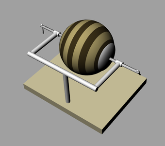

I always like to start by sketching whatever it is I am wanting to make and then drawing it in 3D - I use Rhinoceros, Sketchup is also a great tool and often found to be more accessible, it is also free.
The design I came up with is basically two metal cups which squeeze the ball, suspending it, which allows a cut to be made using a bandsaw. The two cups are fixed to lengths of threaded rod to allow them to grip the ball very tightly.
The ball is approximately 86-89mm in diameter, it varies depending on where it is you measure, I guess it was handmade so it's not perfect.

Step 3: Build the Frame
U Shape:
- I used the donkey saw to cut up my 10mm square section in to 3 pieces - 2 60mm long and one 130mm long.
- Using the pillar drill i made a 5mm ø hole in one end of each of the 60mm pieces.
- Using a tap and die and cutting paste I cut an M6 internal thread in those holes.
- These 3 pieces are then welded together to form a U shape.
Upstand:
- Use the donkey saw to cut a 70mm length of 10mm ø steel round section.
- Cut an M10 thread at one end at least 25mm long.
- Screw a nut up the thread and spot weld it in place.
Weld the round section to the U shape at the centre point of the 130mm long bar. This is the main part of the jig, the wooden sphere will be suspended in this U shaped frame.
