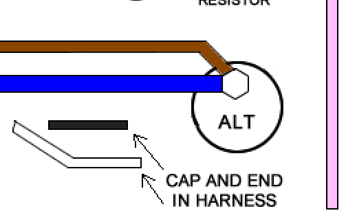

Step 11: Let's Hook Up the Alternator Wires.
I was originally going to put all the wiring in one step but I think that it is best that we break it down.
Lets go back over to the alternator side of the tractor. Right above the alternator is the voltage regulator. Connected to the voltage regulator is a wiring harness with three wires. While the colors can vary mine were brown, blue and black (could be pink).
  1. Remove these wires off of the regulator.
  2. You may need to add wire but we want to combine the blue and the brown wires onto a new terminal.
  3. Cut the old terminals off and combine all of them into one terminal if you need to add wire.
  4. You may be able to use the existing terminals and put them on the alternator as is.
  5. Attach the brown and blue wires to the battery terminal of the alternator.
  6. That is the only connection needed. The remaining wires can be capped or taped off and tied up.
See the before and after diagram of the voltage regulator - generator vs the alternator. You can choose to remove the regulator or leave it in but disconnected.
Please see the image of the 24v system with the generator and voltage regulator below.
vs. The new 12v system below.
